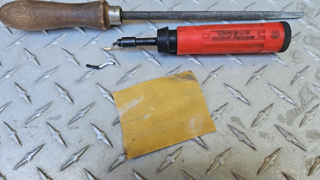

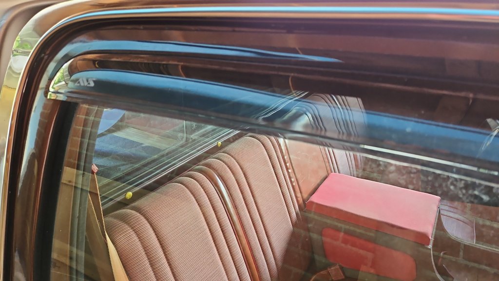

Last year I got a set of those smoke tinted window things.
Read the instructions and carefully positioned them, just right, before peeling off the sticky tape backing.
This truck has no A/C so it's always windows down and vents out to the stops....that is until the wing windows now hit those smoke plastic things. Well, buggers!

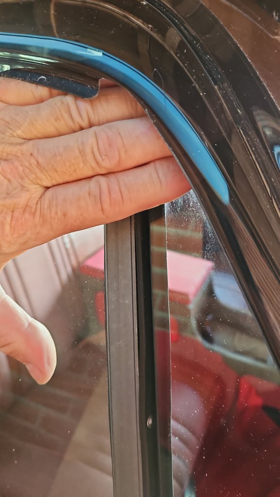

This past weeks heat wave has motivated me to carve out some relief areas in the plastic so the wing windows can swing out to the stops.
I'll tell ya, it ain't easy whittling on that stuff. And the temptation to take the 4" disc grinder to it, is hard to resist, but knowing that would end in disaster, kept me from doing that.
So rat tail file and sand paper was how it started out. That was very slow going, but nothing was getting destroyed either. I kept thinking, man, I need a tool that peels a tiny strip off at a time. On the passenger side it hit me...I went and grabbed my Vargus deburring tool. Used correctly you can peel a steel curl off the edge of a plate and smoke goes with it. They are a great tool and I've had a few.
It took a couple of attempts but soon cute long plastic curls were falling off.
Before I knew it, the passenger side was done...and nothing was destroyed either....which is a good thing.
It's been a few years since I bought a deburring tool and I have not looked up the cost, but not scratching glass or paint or melting the plastic might be worth the cost when compared to the damage.

I thought about a heat gun, but I wasn't sure I wanted a bump-out and to get plastic hot enuf to move needs about 300° (considering most plastic molds @ 350° -375°) and that requires gloves. Plastic hot enuf to move will pick up whatever glove pattern the gloves have...cotton fabric weave ot leather grain...it will transfer.
In other words, you end up with a rough grainy bubble....that you end up cutting off cause it's ugly.
At least that's my past experience with sheet plastic.

few years ago when I went to install them on replacement doors, luckily I remembered they touched. So when I installed new ones on the replacement doors I opened the wings and changed the location of the deflectors as needed.

Back a while ago installing wind deflector on hood of 91, a bit of heat gun is all it took to make room for the hood ornament. Just need to be soft enough to manipulate, but not melt.

A couple days ago, I had a chance to go down the road with the wings open again.
I am happy to report, everything is working just fine.
