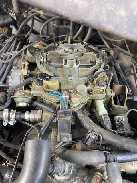

Lorenblazerk5
Oct 27, 2025
11
Los Angeles
Loren
k5
Thanks again for all the trouble shooting tips!
I've done all the suggestions and each item seems to be working as designed.
the Temp sensor (pic below) on right has only 1 electrical probe, which is wired to the mixture controller solenoid on the carb.
Appreciate all the help identifying these crazy smog items on the CA k5.
