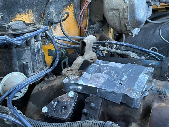

I am a carburetor dunce. I can't make old Qjets work well or stay in tune and I'm too lazy to learn. The last 5 sbc that I have owned I take the offending Qjet off and put an adaptor on the stock manifold and mount an Edelbrock 600 cfm with an electric choke and drive it around. I am not a go-fast guy I just like them to start and drive without having to mess with them Summer 100+ and winter, -15.
