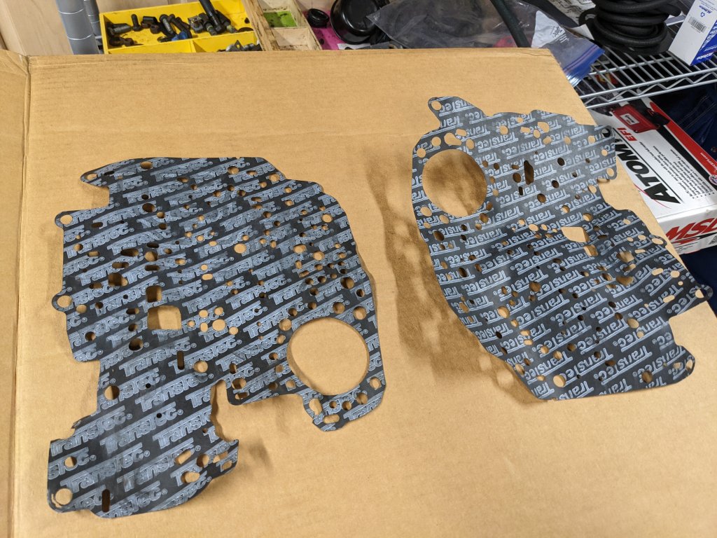

Most shift kit plates are yellow anodized, TransGo plates are black. Stock plates are natural steel with no coating
Hmmm...it was a natural steel plate...however I can 100% guarantee someone other than the factory was in there before I was as there were aftermarket gaskets..
I was looking on the Transgo website and their shiftkit mentioned something about keeping the 350c separator plate and drilling it out instead of replacing it...maybe some shade tree shift kit?
I feel like Quincy, MD (yeah, I'm old! Haha) trying to forensically recreate what may have happened but this truck spent it's life on a ranch since 1999 (last year registered) and the owner passed away so I have zero history...
It wouldn't surprise me if it slipped before I got to it and it just was never addressed..maybe the rebuild had 350 gaskets instead of 350c?
I actually saved all the old stuff I took out.. I was pretty damn careful putting it back together but I'm not a master builder!

I have been reading a few articles here and there and looking at the gaskets I took out, it looks like they were from a shift kit? I was also reading a few instruction books from different shift kits and it looks like for the 350c, you would use the exiting plate and drill out some holes? If so, it would also stand to reason the separator plate was either modified or replaced before I got in there? If all that holds true, it would probably mean that whatever gaskets that came with my rebuild kit were not compatible with what was already in there, much less the dual feed mod I did internally?
I'm pretty sure that is at least ONE problem, if not THE problem? Given all of that, should I try to find a stock 350c plate and gasket set (which is harder than it sounds!) and install or do you think there is an after market plate/gasket set I could use with the internal dual feed mod?
You are right about the early Transgo shift kit. Drilling out a couple separator plate ports, moving a check ball got rid of the shift lag (overlap) between gears. GM designed the trans for mom and pop America. The Transgo kit would bang the gears and chirp the tires on the 1-2 shift and the 2-3 shift. Of course this was tough on the rest of the trans parts.

I haven't had time to troubleshoot the trans for a while but was looking at ordering a new plate/gaskets just to make sure I had the right ones. I did pull out the parts I had left over from the rebuild kit and there were 2 new gaskets for what I'm assuming is a non lockup th350 so that leads me to believe I did at least put the right ones in!
