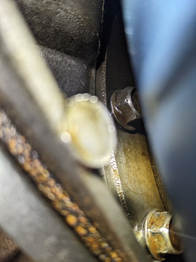

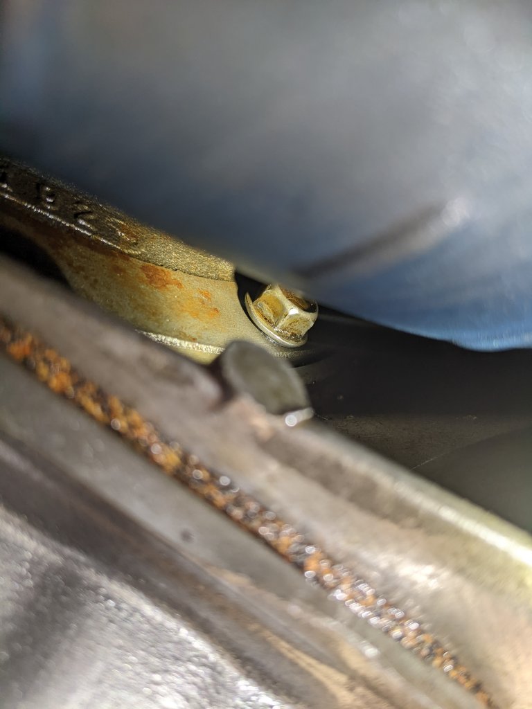

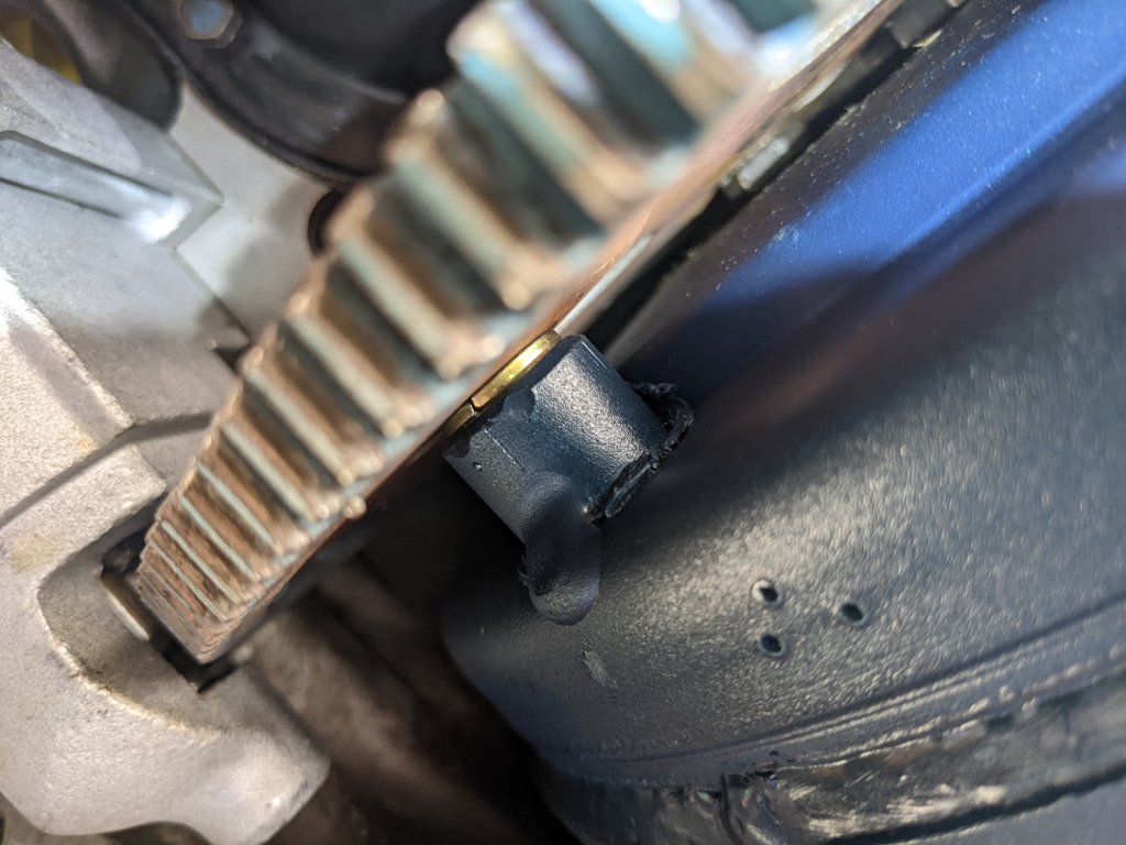

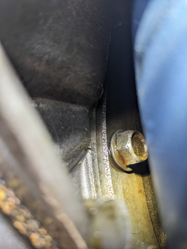

I pulled off the lower bellhousing and it doesn't look like there is some massive leak..the TC is dry and it looks like it just leaking from the bolts a little bit..I have seen more than a few th350's leaking for more that function just fine..
One thing I did do when I installed it was to shim the TC to flywheel with washers because the gap was larger than what I saw spec'd somewhere (can't remember but I can find it if need be)...come to think of it do you think this might be causing some endplay issues and causing some (or a lot) of excess friction?

You should not put washers in there as shims .
Matt69olds
Jan 8, 2018
2,344
3,585
Central Indiana
Matt
GMC 1/2 ton
455 Olds
Technically, you are correct. If the converter is built correctly, there is no need for shims.
Ideally, you want 1/8-3/16 clearance between the flexplate and converter with the converter seated completely into the transmission pump. 99% of the time, the clearance is correct. Occasionally you will find a converter with them overall build height is too short. This sometimes happens when the converter is cut open and rebuilt multiple times.

My hypothesis is that the washers are not allowing the assembly to correctly expand when it warms up, causing it to heat up rapidly and causing the slippage...I probably shouldn't even call it a hypothesis because I believe that means an educated guess, of which mine is the wild ass variety vs educated..

Ok...disclaimer- I haven't got around to a full blown road test yet, however I removed the spacer shims from the torque convertor and I took it for a spin and low and behold the temp at the pan was 114deg F...
Ironically when I took out the shims on the torque convertor, my starter started grinding so I checked the clearance on that and ended up needing to shim IT. BTW- starts 1000 times better now, almost instantly.
I started thinking about it though and I'm not sure why the starter alignment would change if I removed shims from the TC side of the flexplate? Obviously it was off before but it didn't grind and started somewhat normally...
