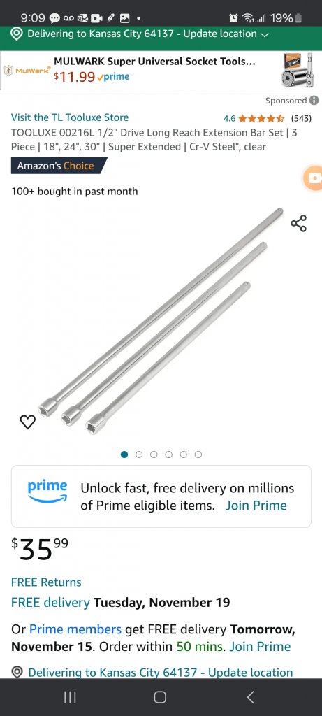

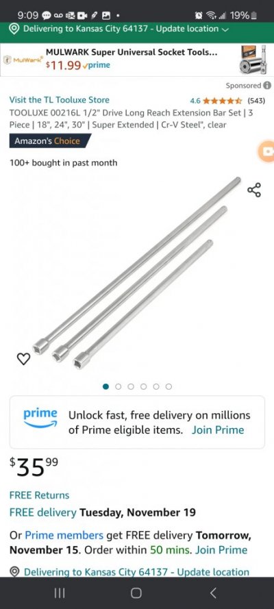

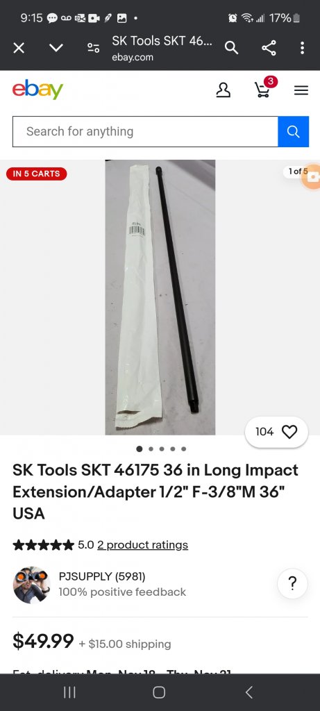

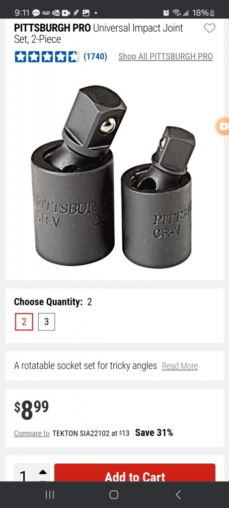

Everyone has their own way but I get all 6 from the bottom and support the engine so the distributor doesn't hit I do pop the cap off. To get all 6 from the bottom you will need a long extension and a 9/16ths wobbly impact socket or a long extension and an impact wobbly universal and 9/16 ths socket. I have 2 very long 1/2 inch impact extensions for doing this,not sure if it could be done with 3/8ths drive. Got pics of stuff that would do it. Notice the wobbly not you're standard unversal,a regular universal gets bound up. Actually just checked Ebay the SKs like I have are listed I have had the 36" and the 20" at least 20 years and have used the crap out of them,they are the bomb pulling transmissions,you can reach all bolts from underneath,and hit them with the impact.
