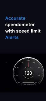

A few alternate options:
Download a free speedometer app for your phone. Doesn't cost anything, and you can turn on speed alerts, so if you exceed the speed limit by a certain amount, it will alert you.
Or If you use Google Maps to see your speed, it will also alert you to speed traps that have been reported by others.
You just turn on an app and place the phone on your dash in front of the spedo.

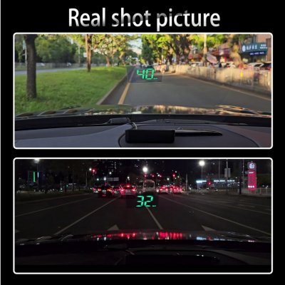

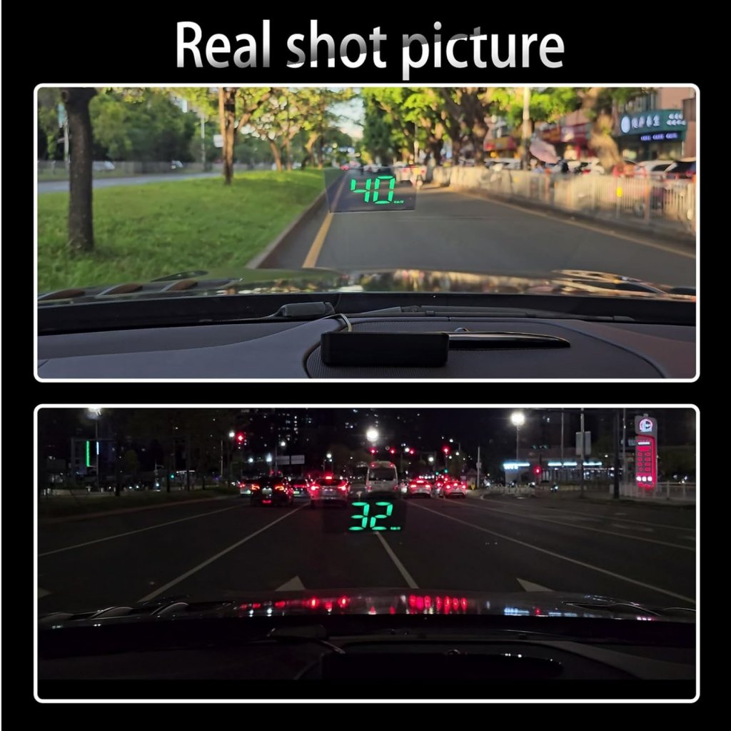

A better option:
GPS speedometer. It sits on the dash, and projects the speed onto the windshield. They call it a "HUD" or Heads up display. You can see your speed without taking your eyes off the road, there is no need to look down at the dash. $10 on Amazon. I have one, and they are cool.
Amazon link for the GPS HUD:

That's pretty cool! I have a speedometer app that I was using. But I like the hud one.
