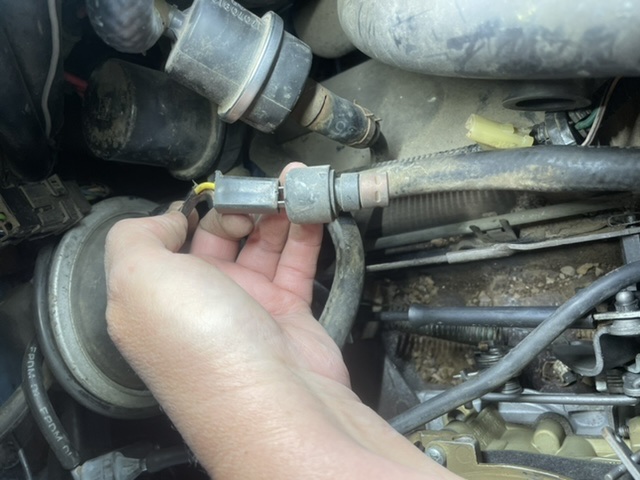

Thanks to everyone. I went
Back and looked at mine and the green wire is actually not going into that connector it just looked like it was. Now That I know it’s not disconnected I just need to Troubleshoot. Bucket I am attaching an image of something at the back drivers side top of engine. Any idea what this should be plugged in to or what it is?

@86c20RN,
By the looks of the bottom of that it has a copper appearance to it. That looks like some kind of temp sensor because that copper end with the indentations on it look familiar but I can't place it.
I have my Autometer temp sensor in that place in the drivers side head. I wanted to put it up on the intake manifold but the water neck is in the way. So I used the common place for it.
