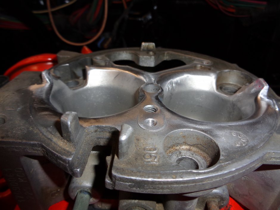

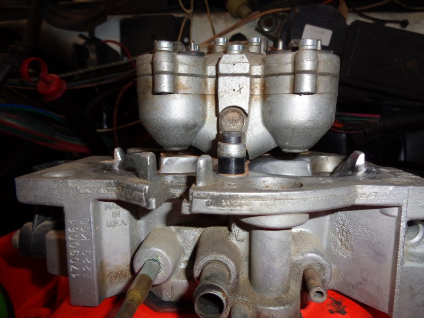

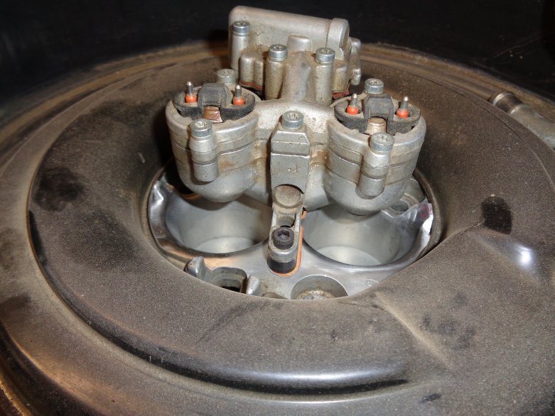

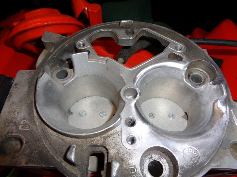

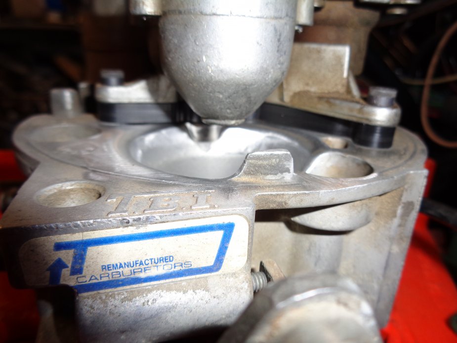

I worked over the tbi in my s10 when I put the 350 in it. I ground off the flange around the openings and added a spacer under the injectors. and a 1 inch spacer between the tbi and intake. and added a power charger to my air cleaner witch eliminated the air breather spacer to let it breath better.
I did not grind down the shaft that seemed like a bad idea. I could see the shaft breaking.
it revs a lot faster accelerates better I definitely can tell the difference.
I don't think it really added any power. just made it more able to use what is already there.
when you grind off the flanges make sure to leave a tab to hold your air breather. I have pics of the tabs I left.
I don't have pictures of the power charger its basically a bowl that goes under the air breather to allow it to breath better
