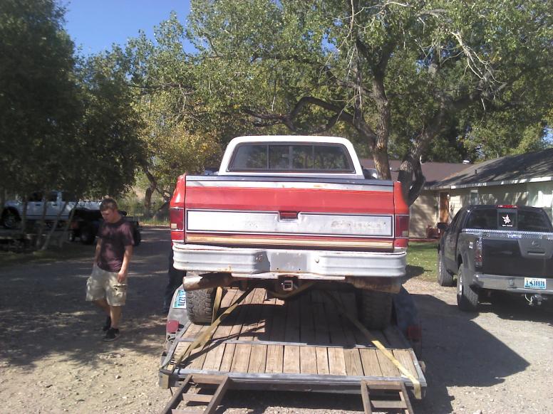

i just picked the truck up lastnight it is missing half of the hydraulic stuff so im going to run the mechanical setup. The cab is in ok shap but has a clear title reson why im selling it all it needs is cab corners, and possibly some floorboards ill take more pictures and check when i get back into wyoming.
For the hydraulic clutch all i saw that was intact was tranny tunnel and gas pedals everything else is gone saddly things i am looking for are a shackle flip kit so i can get rid of the blocks in the rear and a crossover steering setup i already have a brand new 2wd gear box

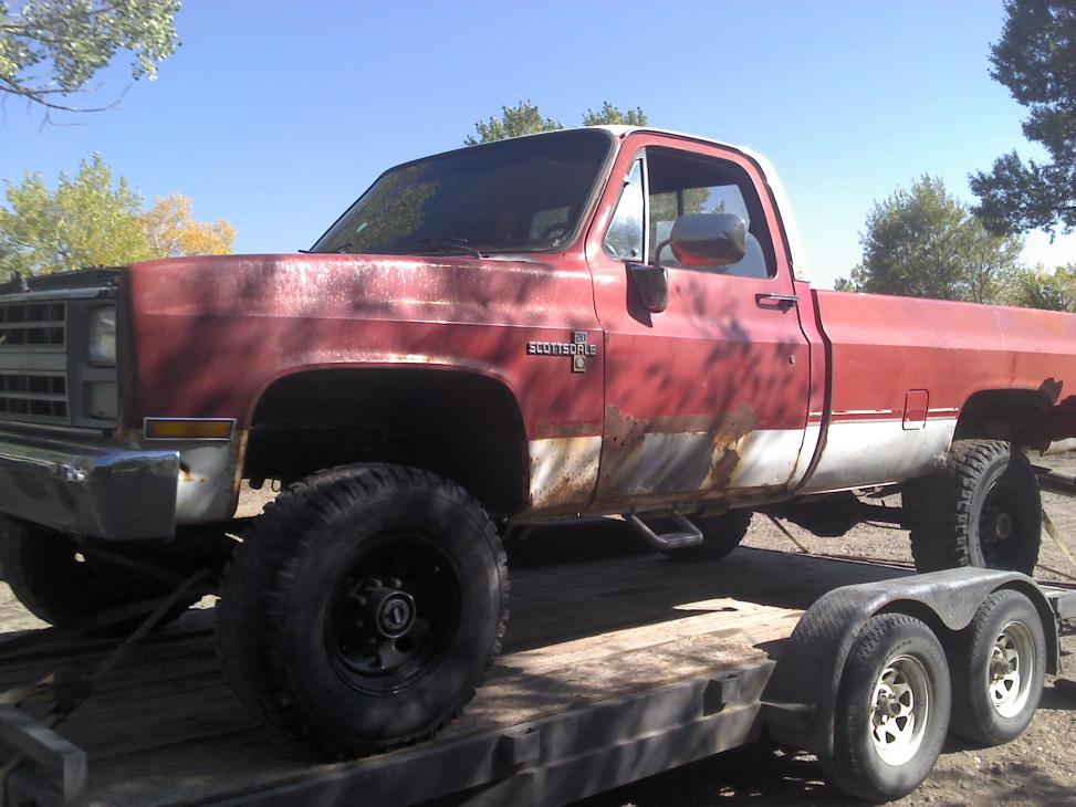

More pictures of the truck
