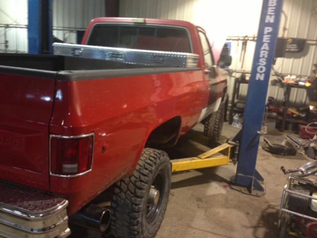

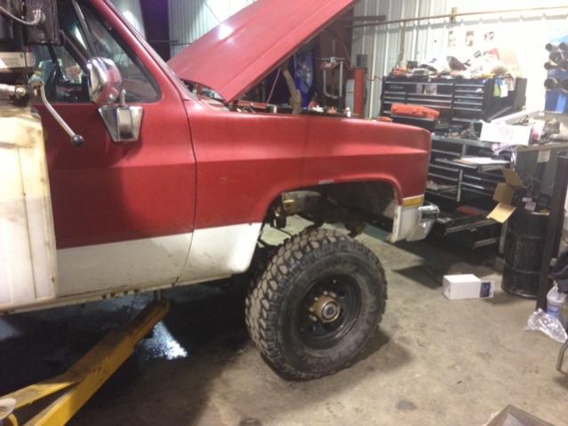

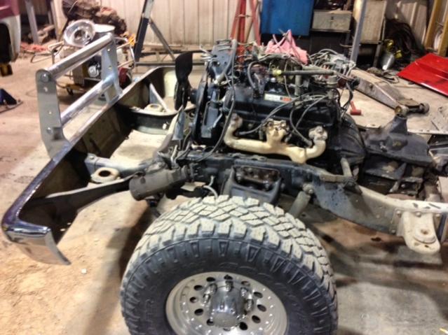

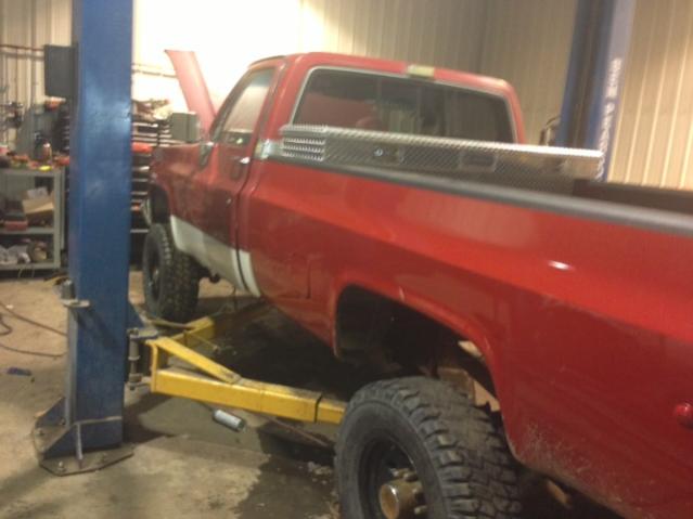

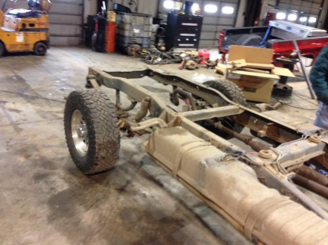

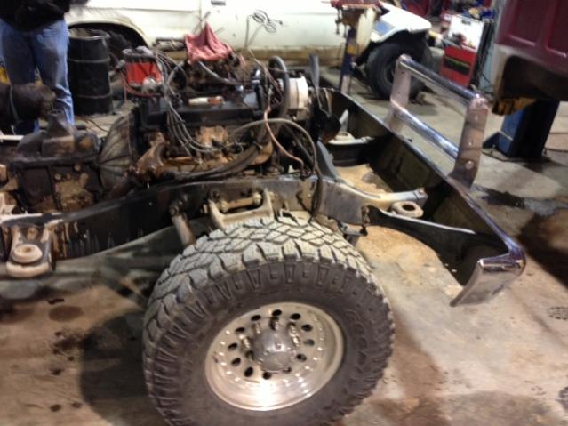

update
just giving a update added some new photos got the swap done get my truck back tomorrow here are some pics

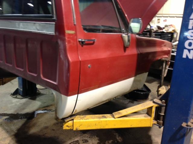

more pics

what i had done was my engine and body swapped over to the 4x4 chassis the shop mated up my engine with the 4x4 transmission and installed my cab and box with my bumpers now they are in the process even finishing up some small things should have it back on the road tomorrow now i have a question did GM use the NP435's in the Chevy's for that year because the mechanic told me its a NP435 i was under the impression it was the SM465 because that's what GM ran whats the difference between the two and where can i find a inspection cover for the transmission ill have to check tomorrow what tranny it actually is when i get the truck back

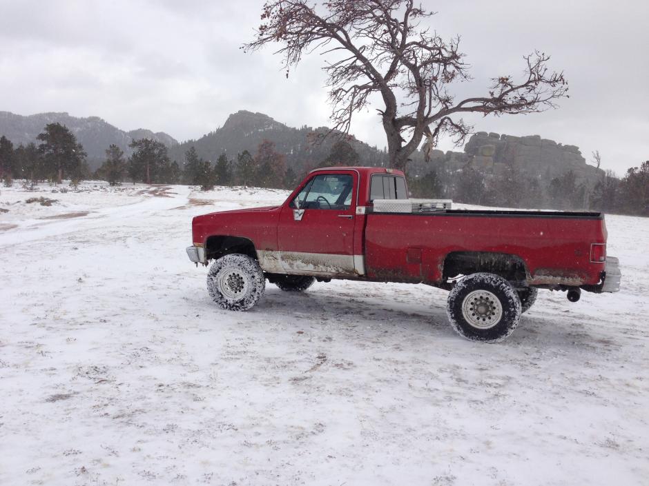

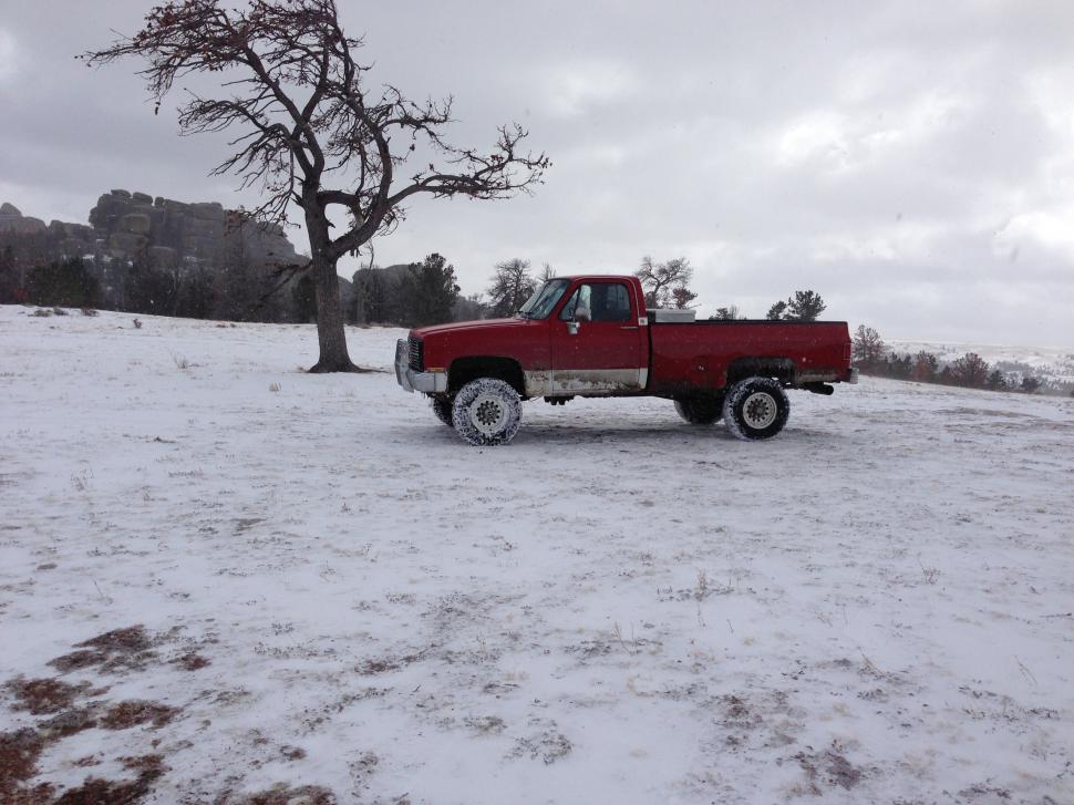

i talked to one of my instructors at tech school we confirmed it is a Muncie SM465 now time to get that inspection cover i did go test out the 4x4 today in the mountains it works great here are some pics
