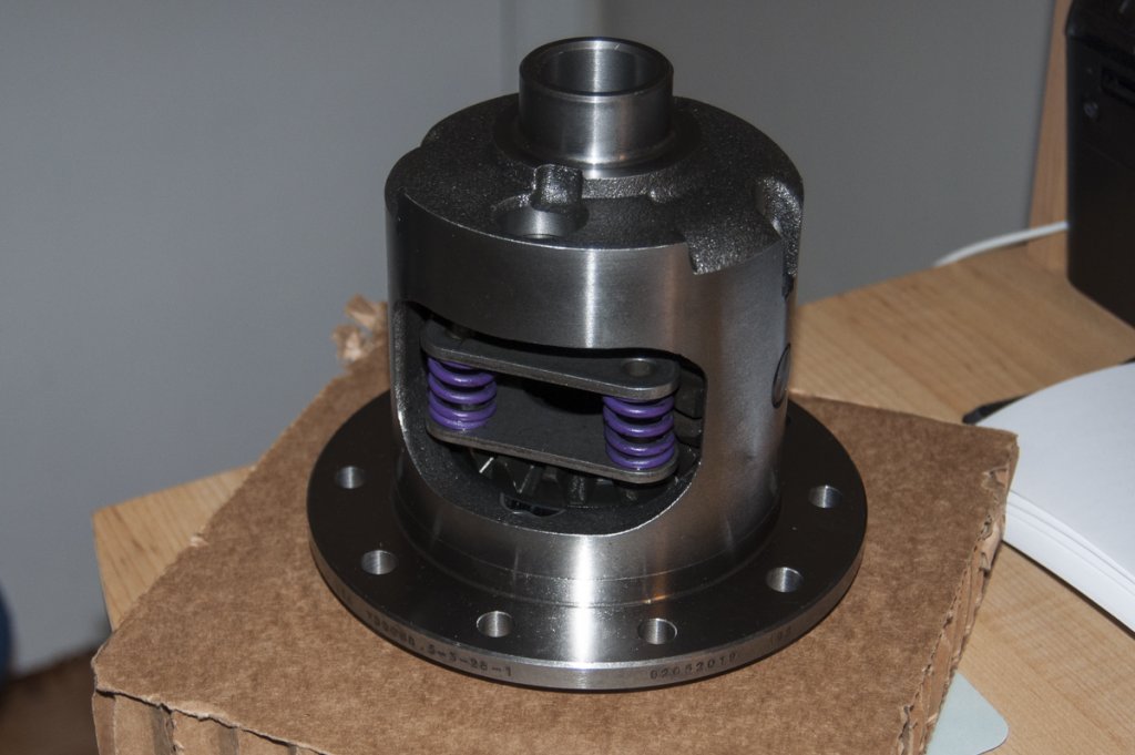

Yukon Dura-Grip best buy for quality at a decent price! i think Eaton is the best over all! :)
