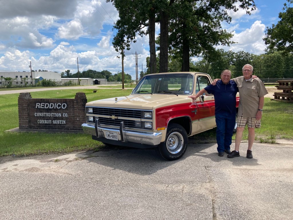

Thanks Doug, I'm considering the same setup as you. If you don't mind, I'd like to get back with you early next year to see how everything is working for you with the 700r4. I did the tire turn and driveshaft test and found out I have 2.73 gears so I would really see some difference. I'm getting about 12.5 mpg in town and still haven't taken any long trips to check hwy mileage. The 3.73 would add 475rpm at 40mph in D and at 70mph, +582rpm in OD. Not sure how the posi trac would affect mpg. I'm past the racing and who has the biggest dick phase and would just like to have a little more performance when I really need it, like passing some slow poke. I've finally got the small block and Q-jet timed and tuned to perfection and it starts and runs as great as the truck looks. The fellow with his hand on the truck is a long time friend, my employer for 27 years and the man who bought the truck in 1984 for the company fleet.
