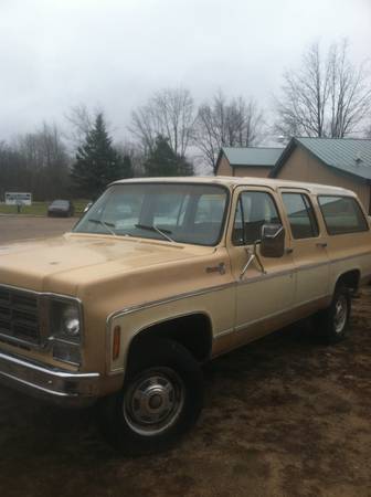

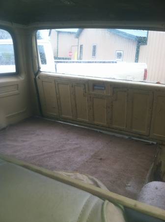

How hard is it to install a third row seat in a square 'burb? What kind of labor and parts are necessary?
This is more of a curiosity question. Eventually I would like to have a 'burb for a family toy vehicle. I look through them on CL every once in while, and actually found an intriguing one, but no third row seat.
Pics of said 'burb, just because.

I had one with and one without. the inserts are in the floor of the one with, but the floor of the one without was smooth. I would imagine it to be a lot of cutting and welding to make it work. I don't want a third row so I wanted to swap the one in my 91 to my 89 that I sold to a friend (he wanted one) but we decided it was too much work even if we could find the mounts in a junkyard. My Third row seat is being used as a bench in my exercise room! :p

Other half-arsed research has backed up what HJ said. The mounting points are not in those not equipped with third row.
These are a couple of excerpts that explain what I failed to word in my head just now...
"Adding a factory 3rd row may be a bit of work. The floor structure that the seat latches into is spot welded into the floor. I suppose you could modify it to clamp in but safety and ease of removal would be two points to consider."
"You have to cut out and weld in the floor support/catches to put the third row in."
So there you go. Maybe it would be just as easy to fab in some newer generation seats if I were to ever embark on this journey.
