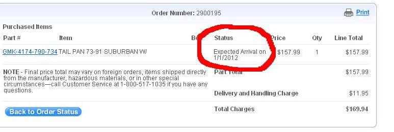

I just got ****** BY SUMMIT. :flipthebird: :flipthebird:
I had a feeling it was going to happen too, god damn bastards. :flipthebird:
attachment.php
24,922
7,067
Fukin told me I would have the part by the end of November, now it's next year, drop dead..... :flipthebird:
And they didn't even tell me it would be pushed off, I went in to check and saw it, bastards didn't even email me or call or nothing, but they can take your money fast as ****. :flipthebird:
