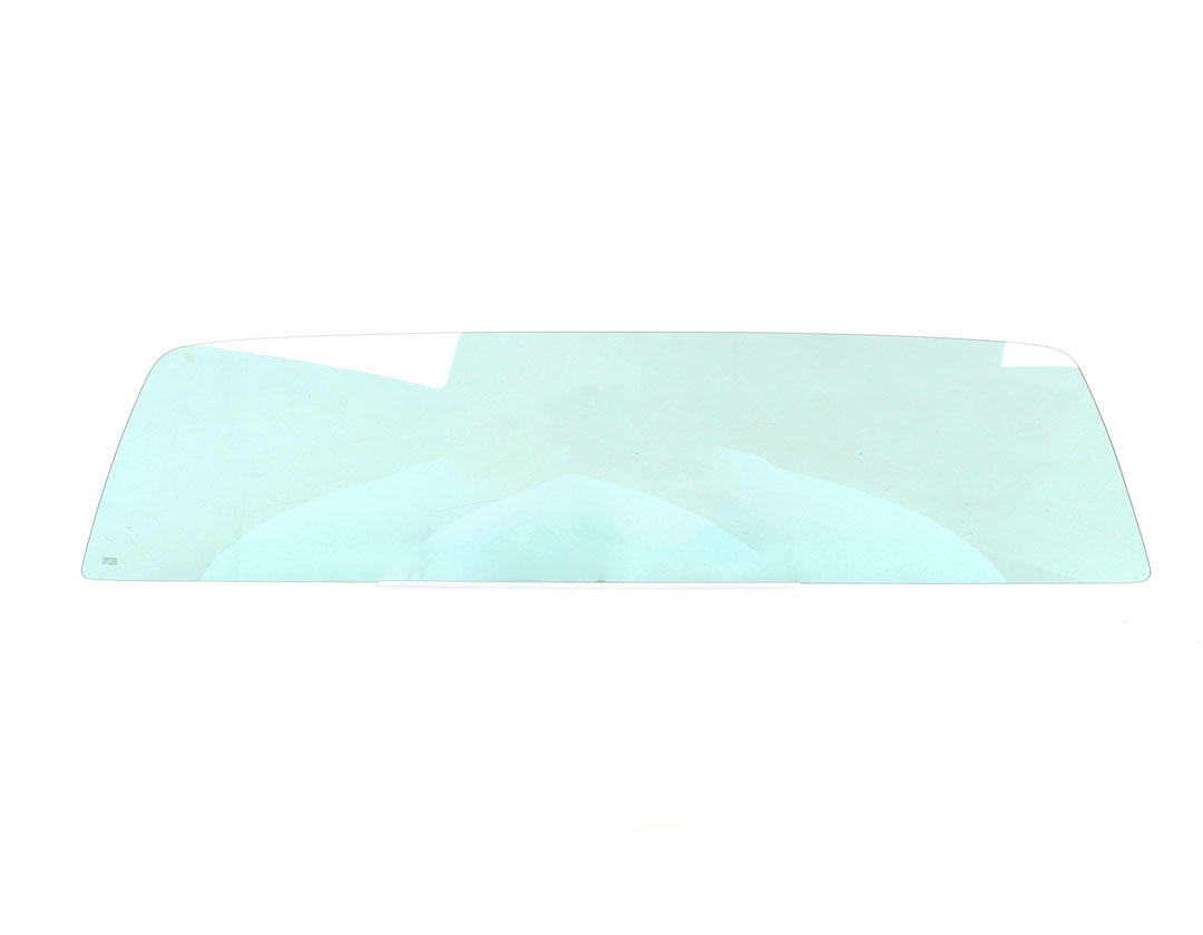

I'm looking to replace my rear window for a 1974 K-20. It has a slider. I don't know if it's factory. I wanted to change it to a solid window.
Everywhere I look it's called a "large" window. They approx. the glass size to be 16"x64". The problem is that is beyond the size of the outer edge of the rubber by about 1/4". I would expect the glass to be about 15" x 63" or smaller.
When I look for the small window, it's really small. 12" x 38".
Am I probably safe with the large window? Any recommended sources?

There are no "large" or "small" back windows in these trucks. They're all the same size as far as solid glass. There are differences in the sliders however. GM sliders use the same gasket as the solid back glass, aftermarket ones typically use a different gasket. But the opening in the cab is all the same. The only squarebodies that got a small back glass are medium duty trucks
So you'll need this if you want tinted glass:
This if you want clear:
This gasket:
The trim:
This gasket:
The trim:
I just got a one piece rubber gasket (no groove). I may live to regret that. I've done this before on a Toyota so I'm familiar with the process but I'm sure the fit won't be easy.
