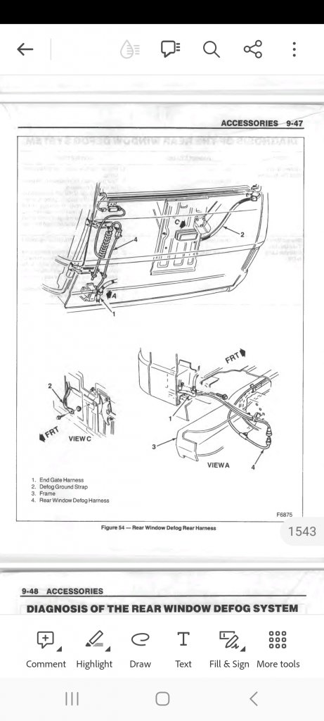

Hello,
I am replacing the rear glass on my square body suburban.
When the original glass was broken some years ago, I was unable to find a heated replacement. Recently, I was able to find one at a scrap yard.
The ground strap is attached to the bottom of the glass on the far right of the passenger side of the window.
However, it has been so long since the original window was removed that I do not remember where to ground the other end of the grounding strap inside the tailgate.
Anyone know?

from the service manual

Awesome thanks!
I need to find that service manual.
