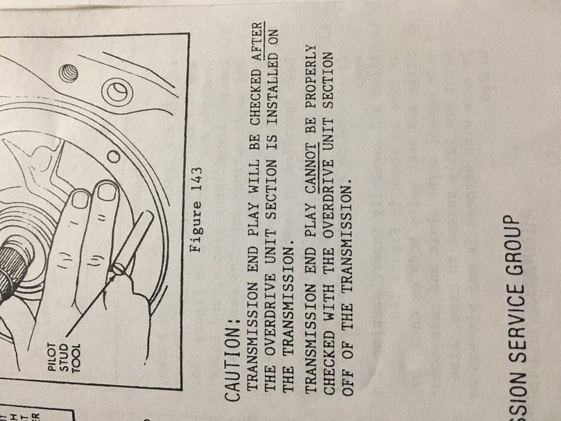

I'm rebuilding a 46 rh as we speak. Lol
Well there you go. If the ATSG Transmission Bible says so, then so it is.
Sure glad I didn't make a bigger ass outta myself and said not possible. As said, I'm not familiar with that model. I tell you what though, I won't ever forget it now. And when I see it in the future on other models that might be the same way, I'll sure check to make sure first won't I? :laughing1:
Thanks for helping out. See, we're not only stuck on 1 breed for our expertise as a group. :cheers:

Hopefully that info helps before he pulls out all his hair. I've built quite a few 700r4/4l60 but this is only my second chrysler trans so im quite intimate with the book.
Well, crap! Why doesn't my ASTG manual say that???
What version manual you got? Gotta source for download? Must've been some sort of update on a later version..
Mine, it says nothing about that, just says to check by moving inputshaft up and down.. BLARG..
Thanks for the help!
I was feeling stupid for not checking it in the begining, and pulling my hair out trying to figure this out!

The book I have that has the large note about checking endplay is a500se/42re
Book. Its dated 1/9/08. I also have one dated 1/1/2000 for the 42rh(a500)
46rh(a518) and 47rh(a618) that does not mention that at all. All it says is check endplay before dissasembly for reference.
