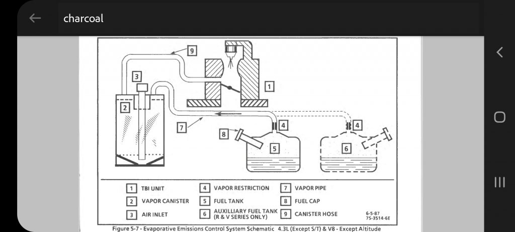

sounds like the tank may be being pressurized.

Agreed, the TBI sending unit for a Suburban/Blazer type tank should have 4 fittings on it. One is for the filler tube vent. Then you have fuel feed and return. Last one is tank vent. The tank vent line either has a wobble check valve similar to your diff vent for non-emissions vehicles, or it runs up to the charcoal canister like yours.
Without having that hooked up or plugged off, fuel vapor can be condensing at low points in the line or filling up with fuel when you fill the tank up. Then when it gets hot and the fuel in the tank expands it blows all the liquid in the lines out. The normal system would be running through a charcoal canister and then into a manifold vacuum port on the carburetor to actively pull the vapor out of the tank and keep it from getting clogged or filled up like that.
I would suggest you either restore the entire system to the way it is supposed to be(install charcoal canister to that hose and then line from other port on canister to the throttle body vacuum port), or disconnect the vent line from the tank and install a short check valve to prevent water intrusion while still allowing it to vent.

Assuming that this only happened once while idling there may not be another problem. The line being plugged have stored a fair amount of fuel and the pressure in the tank push open the taped end of the hose.
Plug the line with a bolt And a clamp see if the truck stays running and if you build pressure in the tank. If this works you can drive to get the canister

Its not the cheap fix, but it is the quick one. Go down to the local parts store and buy a new canister. The ports will be labeled, plug the one from the tank into the one labeled "tank" and buy the right sized emissions hose to run up to the plugged port on your TBI.
