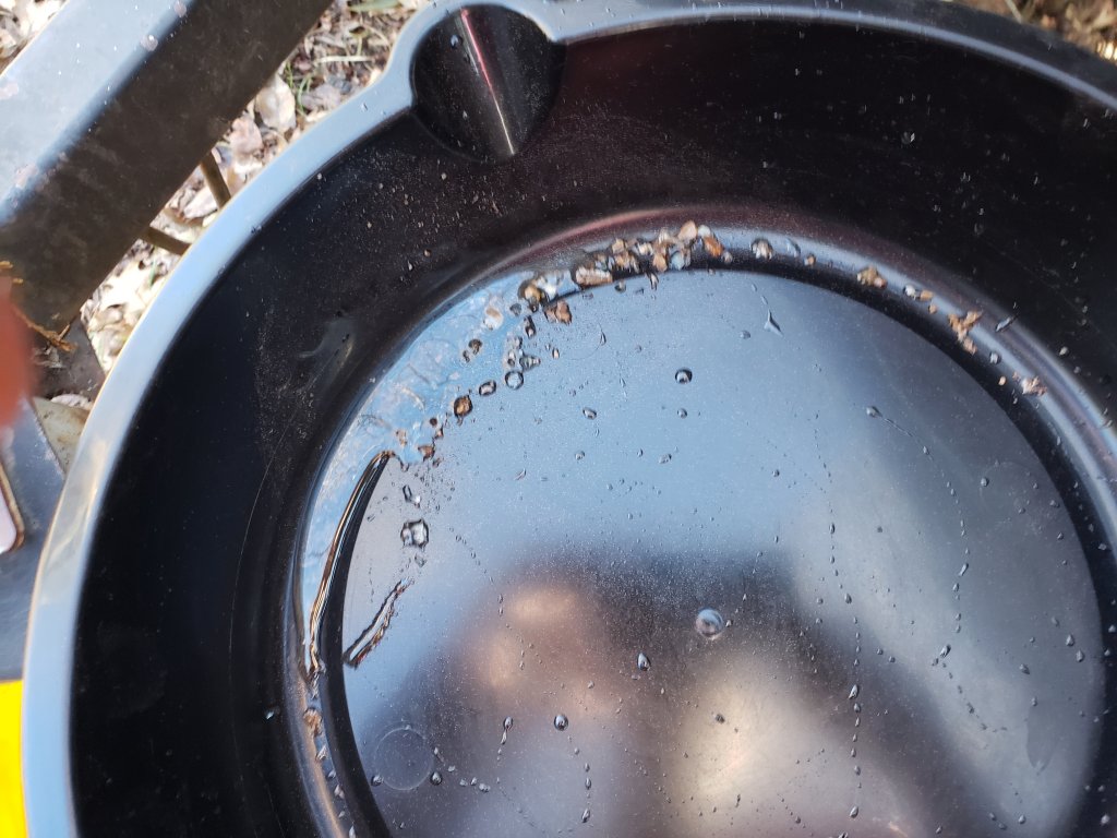

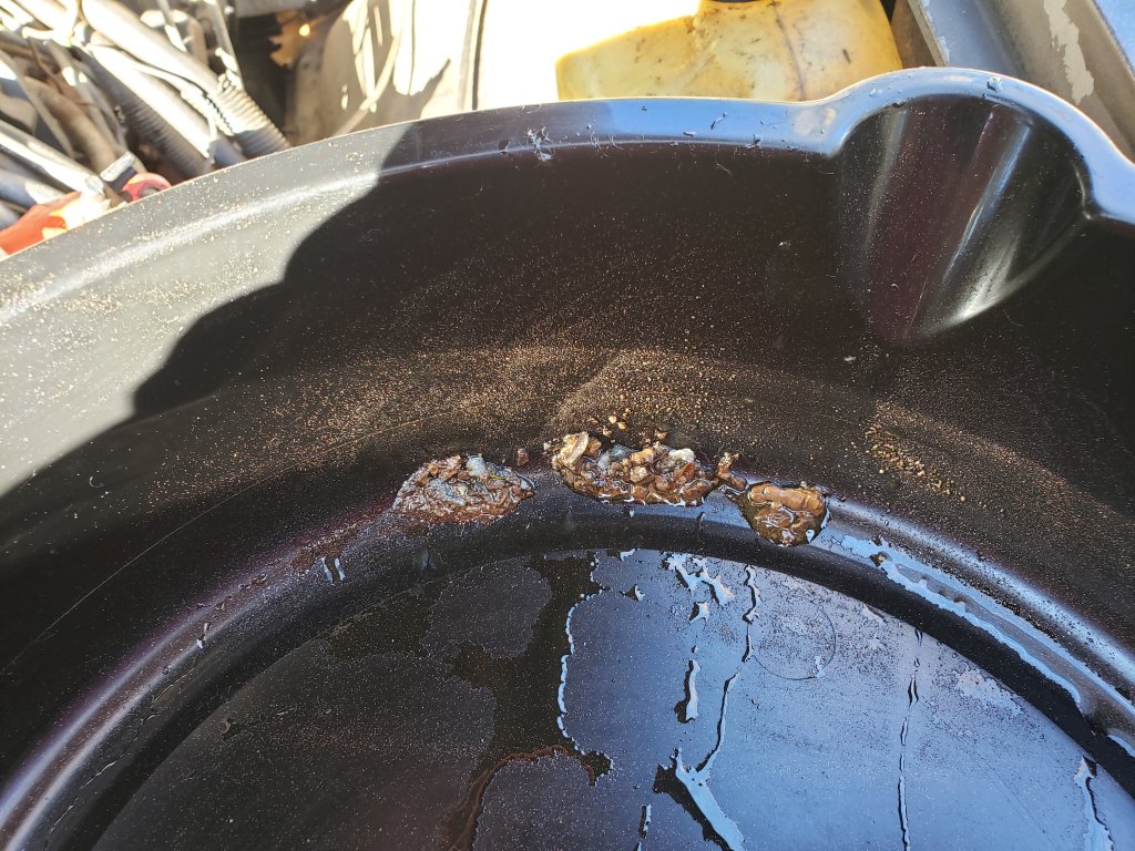

Removed the thermostat and heater hoses, flushed backwards and forwards, this is what came out of the first 2 cups of water on the backflush. I'm soaking in a light solution of water/vinegar and will reflush in a couple of hours. So far no leaks inside which is a very good sign and water appears to flow freely now.

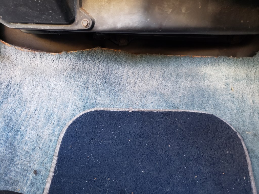

Just in case it also disconnected at the control box, can you remove it without removing the Guage cluster? The pic looks like you can.
