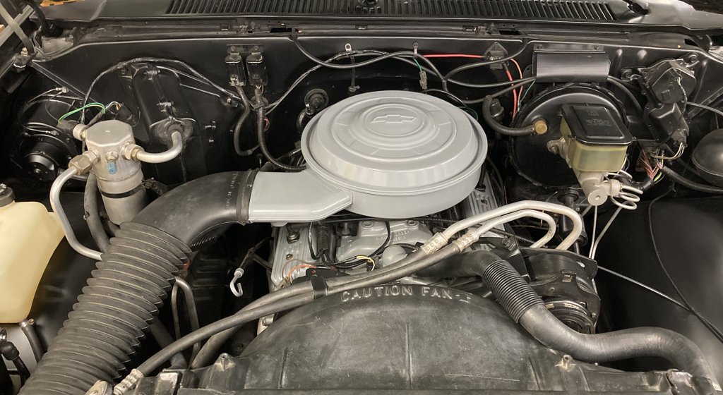

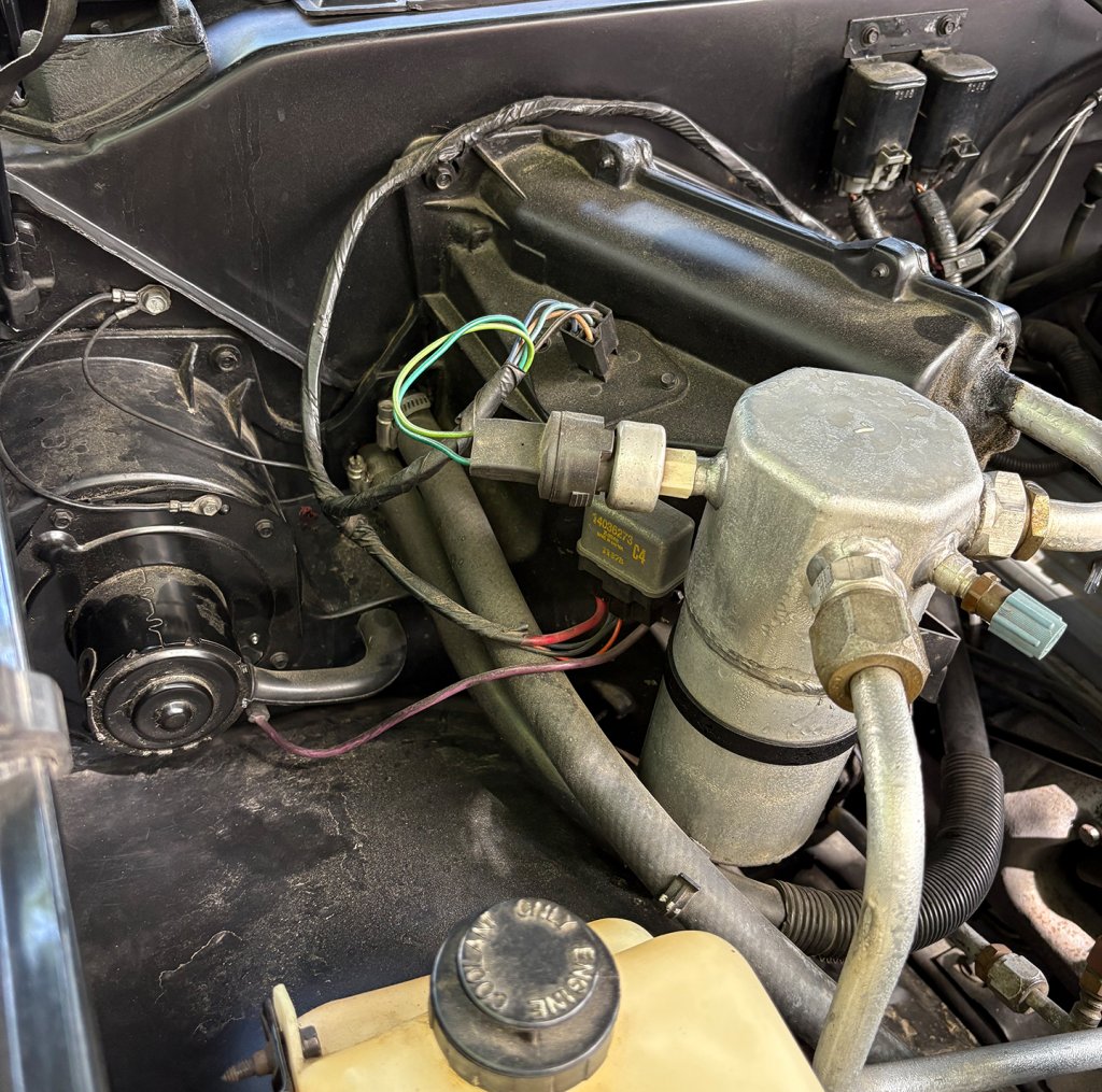

But I'm running into the exact same problem all over again this summer: the cold air (any air) just completely stops coming through the dash vents when I come to a stop (no matter what fan setting I'm on). The A/C compressor/clutch is still doing its thing, just zero cold air coming out the vents inside. I just checked this weekend and it seems like the "new" blower motor is not working - which makes me think there's something else wrong - something causing blower motors to fail prematurely. Would anyone here have any ideas what might cause this?
