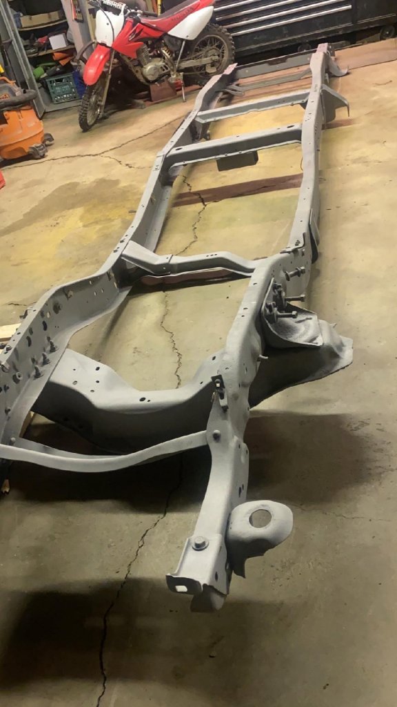

Qe just got ours sandblasted and to my suprise there was no cracks on ours. We are going to be putting the bolt on plate for good measure to keep it from cracking in the future.

That is pretty rare. I will say that every time someone tells me that they don't have a crack, after stripping the paint and removing the box, I have always found a crack. On my '77 C10, I inspected it very thoroughly and even had a frame shop take a second look before sending to powdercoat and didn't see anything. After blasting, I found a very tiny hairline crack that I had to weld up.
On that truck I have the autofab brace to the rear of the box and the Ridetech triangulation braces up front. C30's have a triangulation brace and I've always wanted to see if I could adapt it to the C10 frame.
Maybe because mine do not have power steering?
