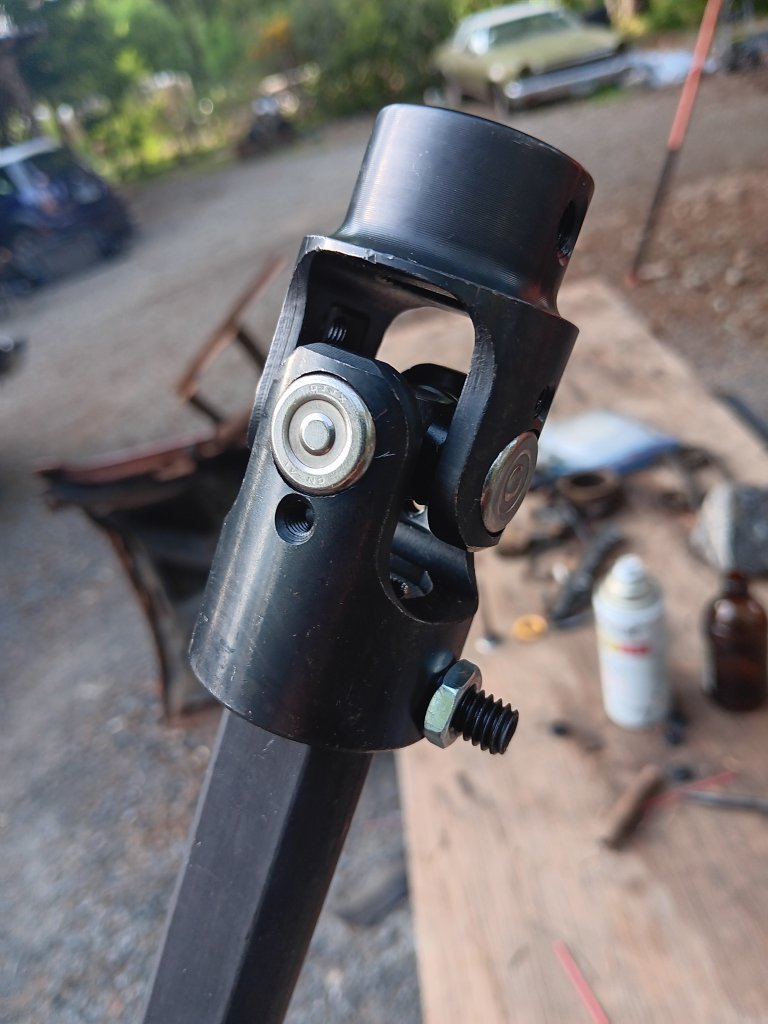

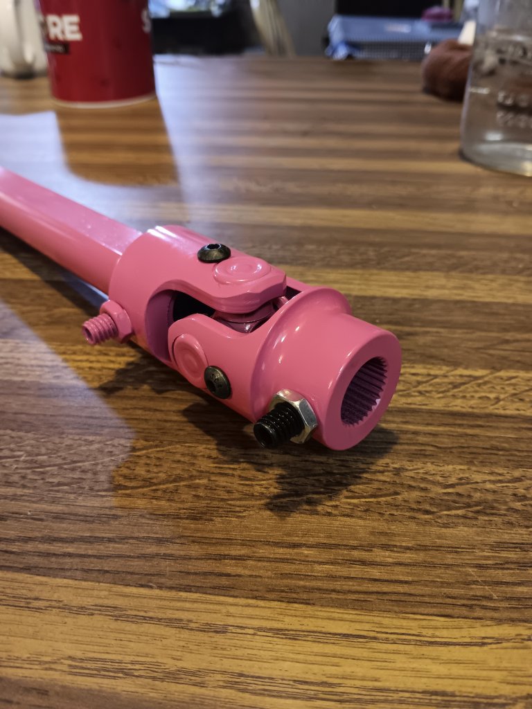

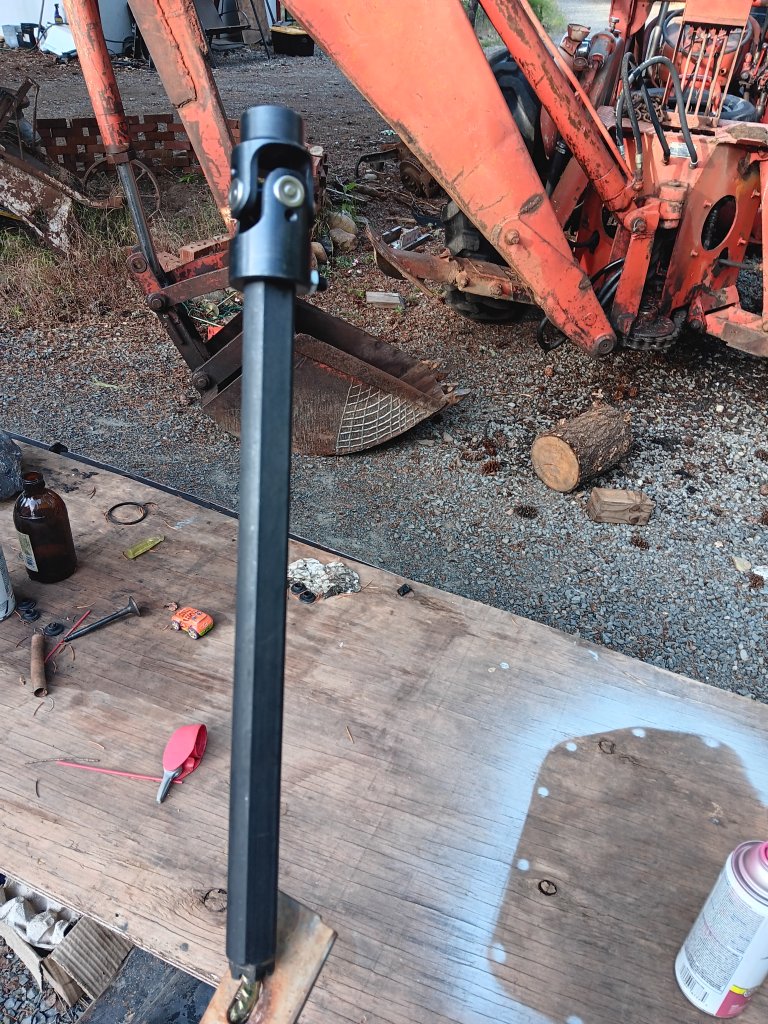

You can buy couplers in different spline counts and make your own. I'm about to eliminate the rag on our 99 suburban.

That looks like a nightmare waiting to come true imo.
What are your thoughts? I'm glad you said something. It got me thinking and I'm going to drill and tap a much larger set bolt to hold it to the box and see how I feel about it then.

Looks like a death trap to me it appears very dangerous. One errant rock or stick would lock the steering wheel. Obviously not made for "mudding". That is my thought about that. Hope the throttle don't stick. More for you!
