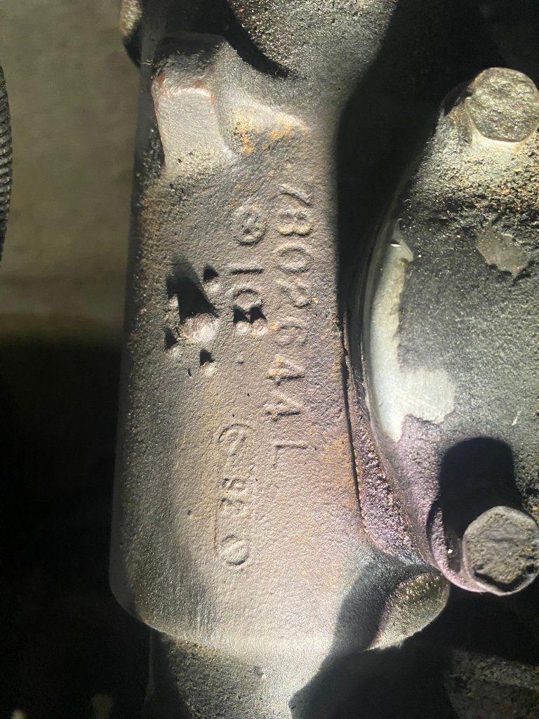

In the same boat here. The steering is loose and the box is wet with fluid. Biggest problem is our garage was demolished last summer and we are getting a new one built but all the tools- at least the majority- are in storage near Pittsburgh in a POD in a warehouse. 1978 K20 new to us over the winter.
