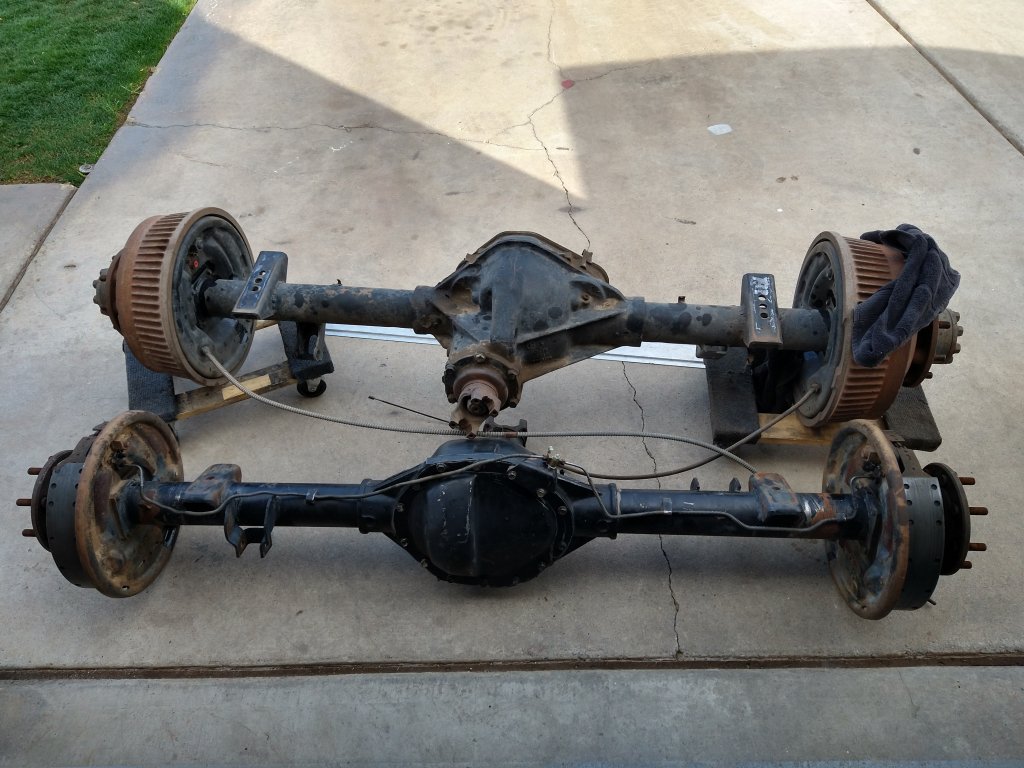

It will NOT bolt in place of your 10 bolt. You have to relocate the spring perches and shock mounts. I've done it many times.
