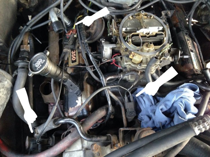

Also, in the pic above, The green and yellow wires that ran to a harnest to the left of the egr. The harnest is connected to 2 vacuum lines. Can those vacuums just be capped at the harnest. Or does the vacuum effect that green and yellow wires. By the way thanks for all the help.

Ok took a better pic with a hand pointing to the harnest with the yellow and green wires on one end and 2 vacuum hoses out the other. From there, one vacuum goes to what I think is the air pump(yes or no?). The other vacuum line goes to a vacuum connecter with 4 ports that is screwed into the intake manifold. The other 3 ports on the connector all go into ports on the Q-jet. Being able to cap or do away with the 4 ports would free up 3 ports on the Q-jet for the egr, tip in, and lock up.

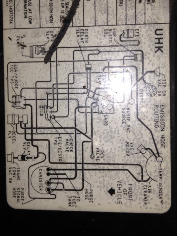

Get me a pic of the emissions sticker, then we can reference what it all is

Here is the emissions sticker.

Oh hell. Like a maze drawn by a blind man..thanks a lot GM.
HAHA!! Yes sir very confusing. My truck is an 85, it has a HEI distributor so does that mean none of the motor should be computer controlled? There is some sort of computer/module in the dash above the glove box..

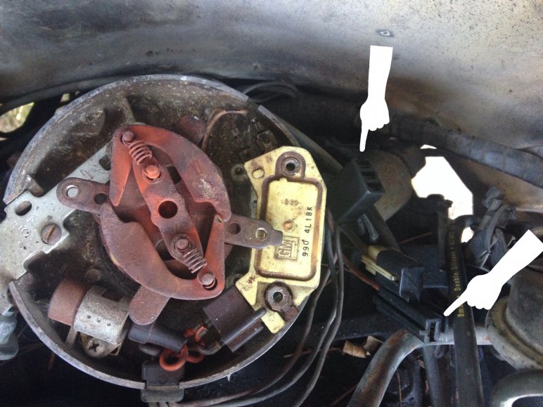

This is good. Check and make sure they are no wires coming out the back of distributor, 5 wires to be exact. That is HEI ESC distributor. If not then we can eliminate the tip in switch, decel valve, EFE valve and diverter valve. That's half of that crap on that sticker.
Where will the wires be coming from on the distributor? Here is a Pic of the distributor cap removed a Couple days ago I replace the ignition coil, and module. I pointed to the 3 wires that come from the frontof distributor to the coil. and not sure where the other 2 wires come from but they also plug into the coil
