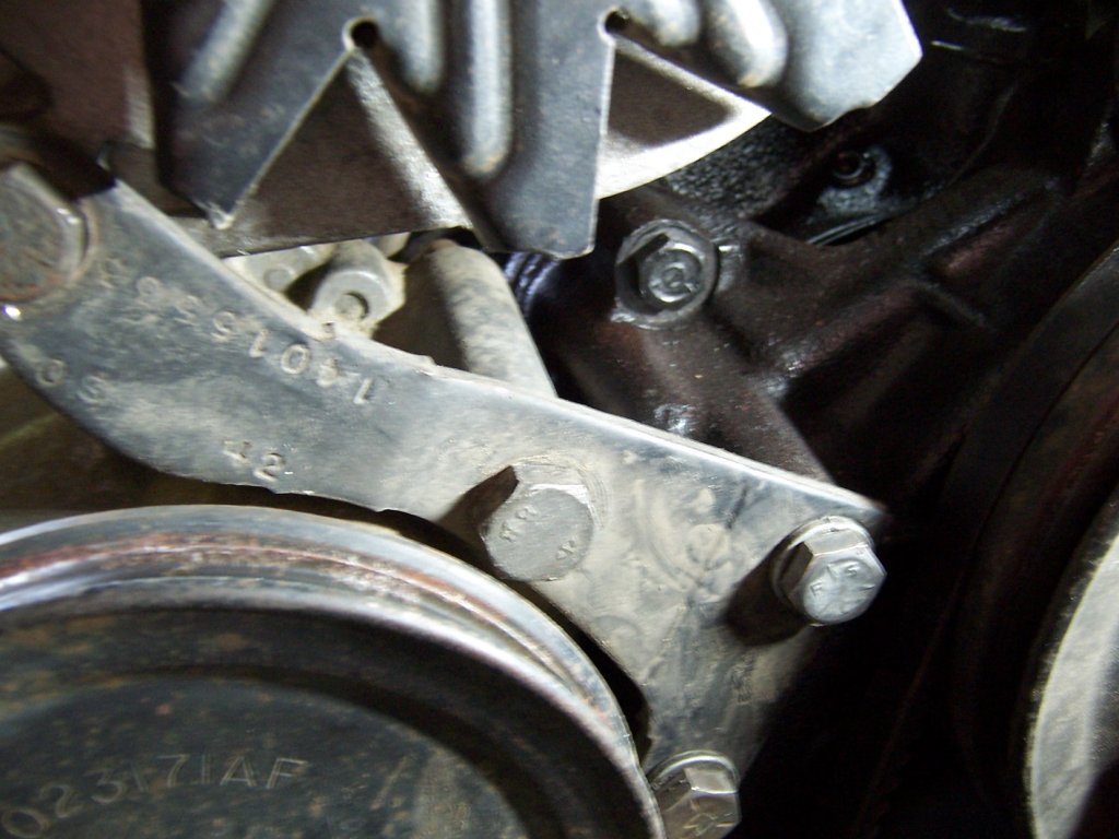

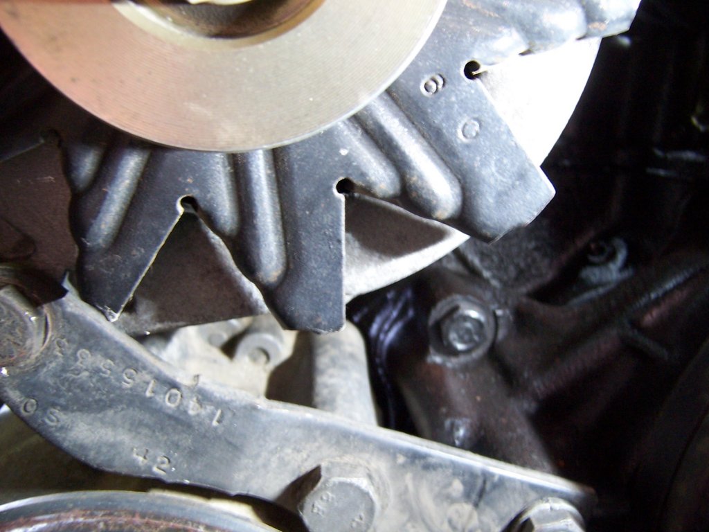

the top bracket is also the bottom bracket for the alt.

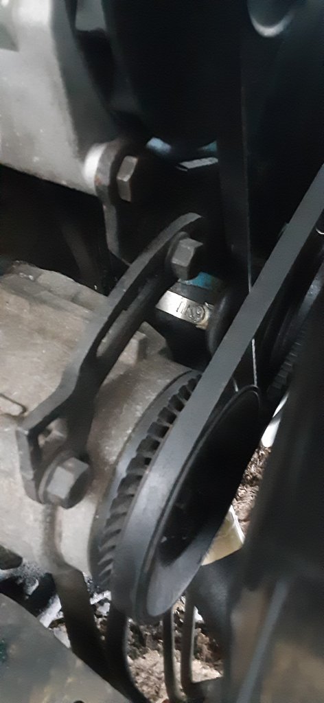

I finally got to take some pics this afternoon, so now that you have seen the way it goes together from Ben, here it is on my truck. Honestly this is about the best you can get for on the truck photos without taking the fan and shroud off.

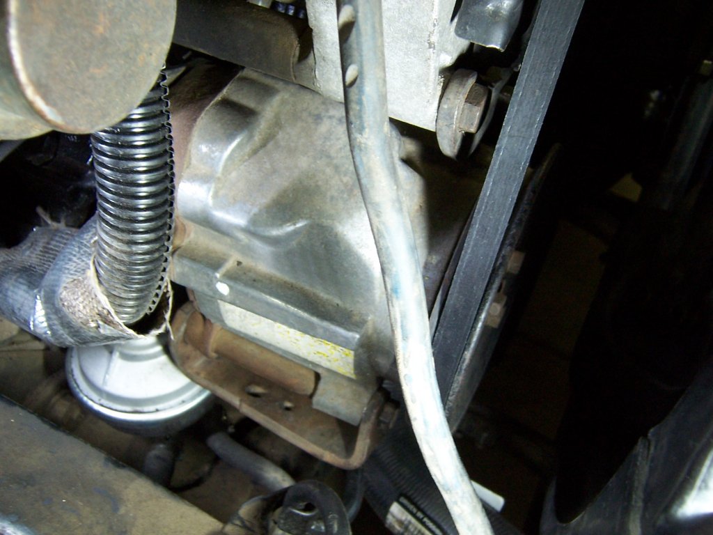

I managed to get a few pictures from above and below at different angles, but as @SirRobyn0 alluded to, it's pretty hard to get in around everything to take decent photos. Alas, my steaming pile of computer ain't playing nice... I've tried about three times to attach 'em, but it ain't happening. If y'all need the views from down below, lemme know, and I'll see if I can post them from something else.
@C10MixMaster Thanks for the pictures you took. From your second shot, I can see where that extra bottom bracket hanging loose on mine is supposed to go. Appreciate it!

I REALLY appreciate everyone's input, pics and guidance on this!! It looks like I was missing the lower alternator bracket from the start...the donor I got the smog pump from (I think it was an '82 Impala) had the "voodoo bracketry" that probably has connections for yet more smog stuff.
