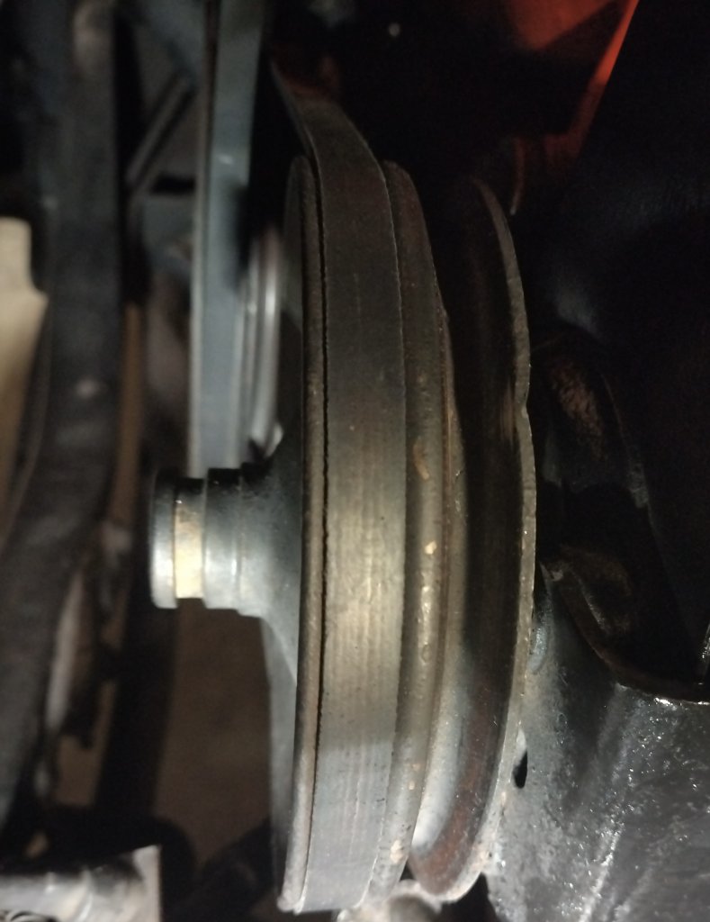

Can somebody confirm the type of ps pump pulley this is? I assume it’s a Saginaw press fit, but would like to confirm. The end of the shaft has an internal hex, then there are threads past the hex.

Yes, Saginaw press fit.
Puller/install tool set.
The threads are for the installer and the groove on the outside snout of the pully accepts the puller.
This is the puller without the center bolt.
