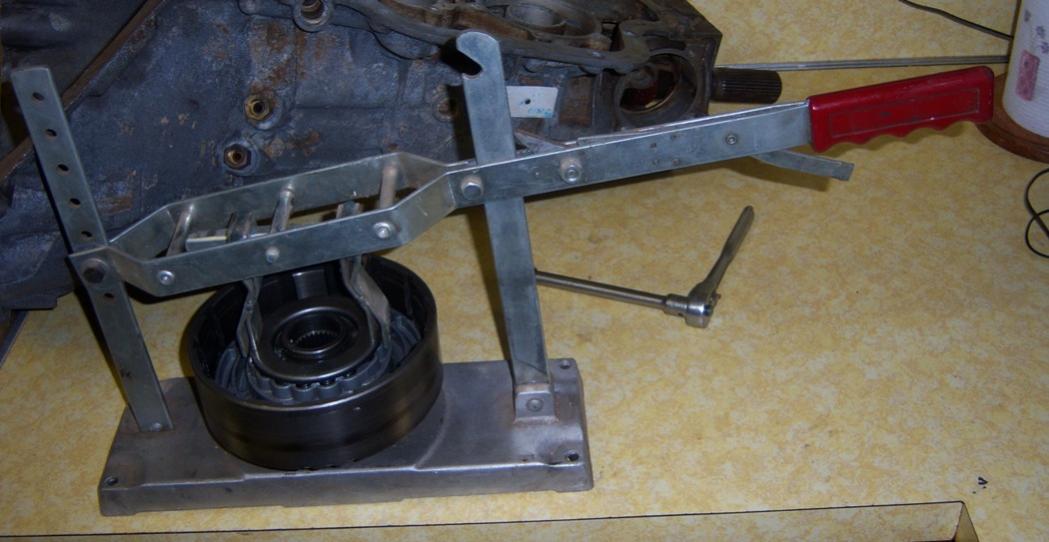

What trans are you disassembling??? Do you have a clutch spring compressor yet? There are several differant types. I happen to use the Haggerty Press type. I also need to find a distributor of Haggerty presses cuz I been having to improvise doing 700r4s since my haggerty press doesn't have the long fingers for the input drum. I gotta buy some more arms for it. Or find the ones I had. Stupid me, lost them. :idiot:

I thnk I'd avoid the $39.99 one cuz it looks like you'd have to remove input shafts to use that one. The $99.99 looks to have locking lugs so you could use it and not have to remove input shafts and also looks deep enough to get into the 700r4 Input drum.

Here is the one I use.

I know. I paid like $79 or $89 for mine way back when. I like it cuz of off all the adjusments and the hole in the center of it. So if you use it on a workbench, just drill a hole in your workbench top so the input shafts can go thru it. There is no reason to remove the input shaft from the direct drum when rebuilding a trans unless you are upgrading to a hardened shaft.
