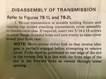

I thought it was half way into reverse for the shifter position?
Beats me. If that's the correct way, I've never done it that way :shrug:

Partially in reverse per the '78 unit repair manual.

Yup, I been doin it wrong!
