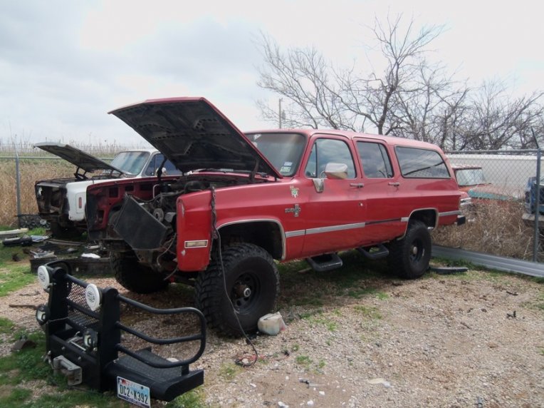

So now my turn.
hirsh, in your opinion, does this vehicle to have a 4 or 6 in kit? I know it's 35in tires if that helps. I got the springs out of this truck and the only markings I see is what I think is part of a part # which I've no luck finding, and Rancho, so I know it's a Rancho spring and the shocks and stabilizers were also Ranch. Shocks are ****, but I intend on using the springs, and drop steering arm. I was thinking I'm prolly going to have to use 33's being it's likely a 4in kit.

Sorry , I like lifted square's so much I start to freak out and loose control , if I had space and more money I would cover my whole property with 70's square's and build a fence around them with more square's.
Anyway , I would say 4" , I dont think rancho had 6" spring's but I could be wrong and those 35's look stuffed a bit.

Kinda what I was thinking. And the rear just had 2in lift blocks and it sitting a little low in the rear. So on my truck, I'll be using the Rancho springs up front, moving the rear spring hanger back to accept 56 inch C6P 3/4 ton springs with the same 2in lift blocks and that should make my K10 sit level and have a bit more strength in the ass end for towing the trailer but yet still ride fairly nice. I'm thinking of 33x10.50 BFG All Terrains with that lift kit. Nothing overkill. Just want a little lift, close to OEM tires and hope to save a mile or 2 per gallon going with the skinny tires. :shrug:
