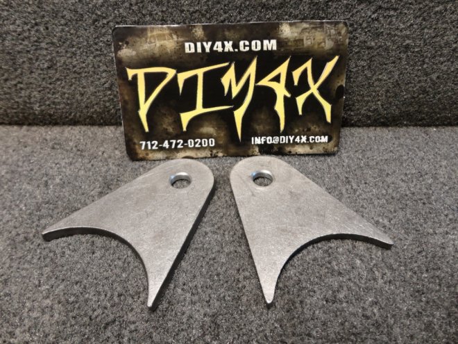

I'm gonna put a Dana 60 and a 14bt ff in and when they were taken off the shock mounts were torched off both. So my question is where should I get these at.
