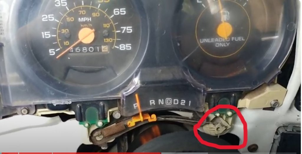

The dash was torn apart in my truck when I purchased it, I want to fix the shift indicator but the part the cable rides in is broken. I circled the broken part in the pic below. Is that a replaceable part or do I need a different cluster? Thanks

As far as I know, that is not replaceable, except to replace the gauge cluster housing. Watch out on used ones as 40-50 year old plastic is quite fragile. These are prone to breaking, and also exercise care with the mounting tabs on the housing.

Unfortunately, it is part of the plastic gauge cluster and not replaceable. There are a lot of them on e bay cheap but beware the tab on the left side tends to break off the easiest and these things are 30 plus years old so the plastic is brittle.

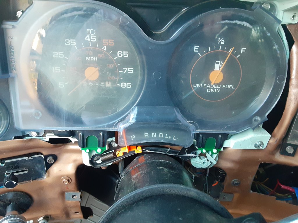

If it is broken, it looks barely broken. Mine by comparison.
Don-Ts idea makes sense.
Or, I wonder if you could glue a flat washer on top of the piece circled in red.

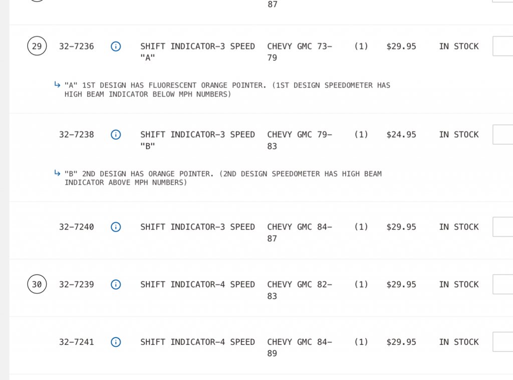

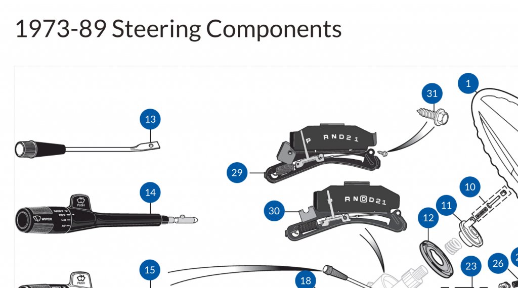

Sorry just saw this reply. LMC website and search gear indicator. See attached pics.
