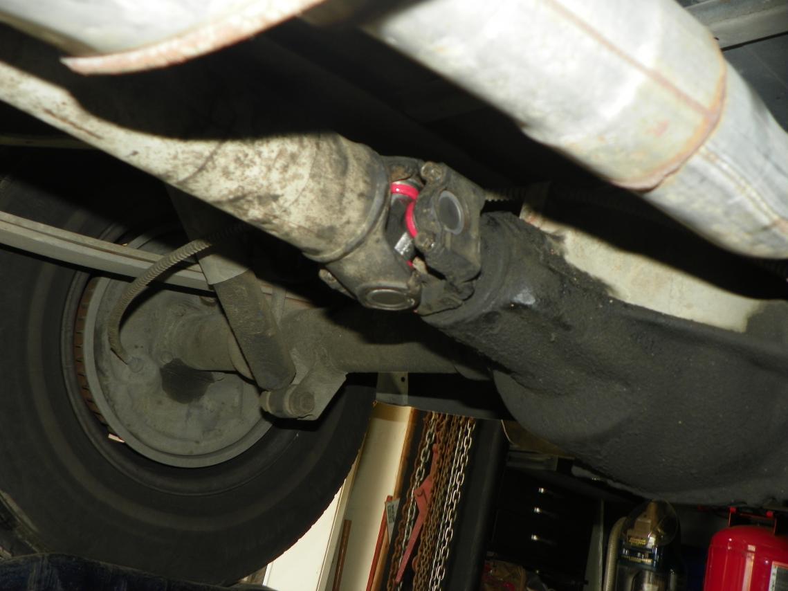

attachment.php
Truck on ramp for starters

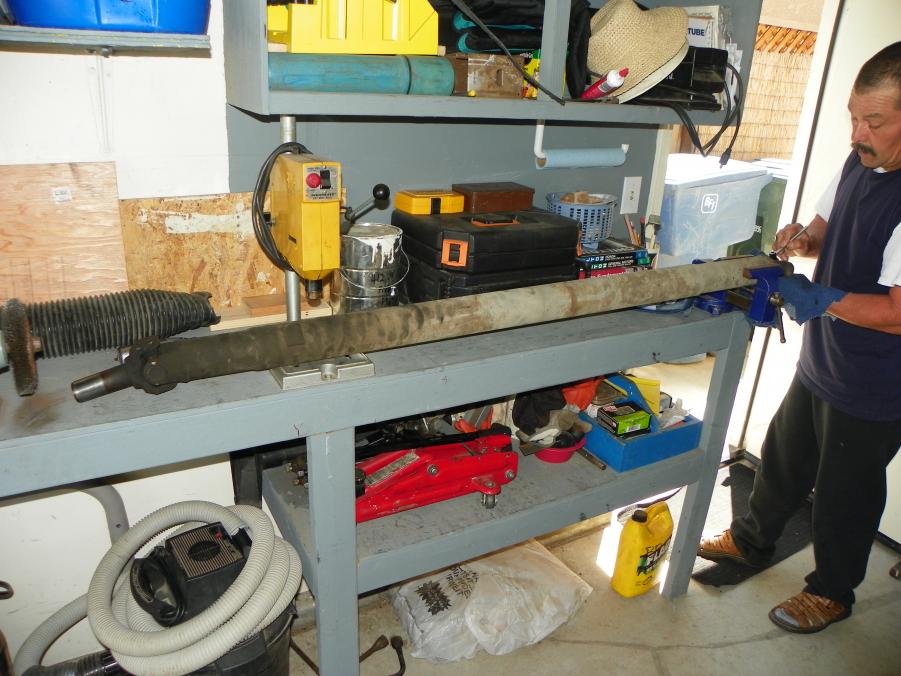

attachment.php

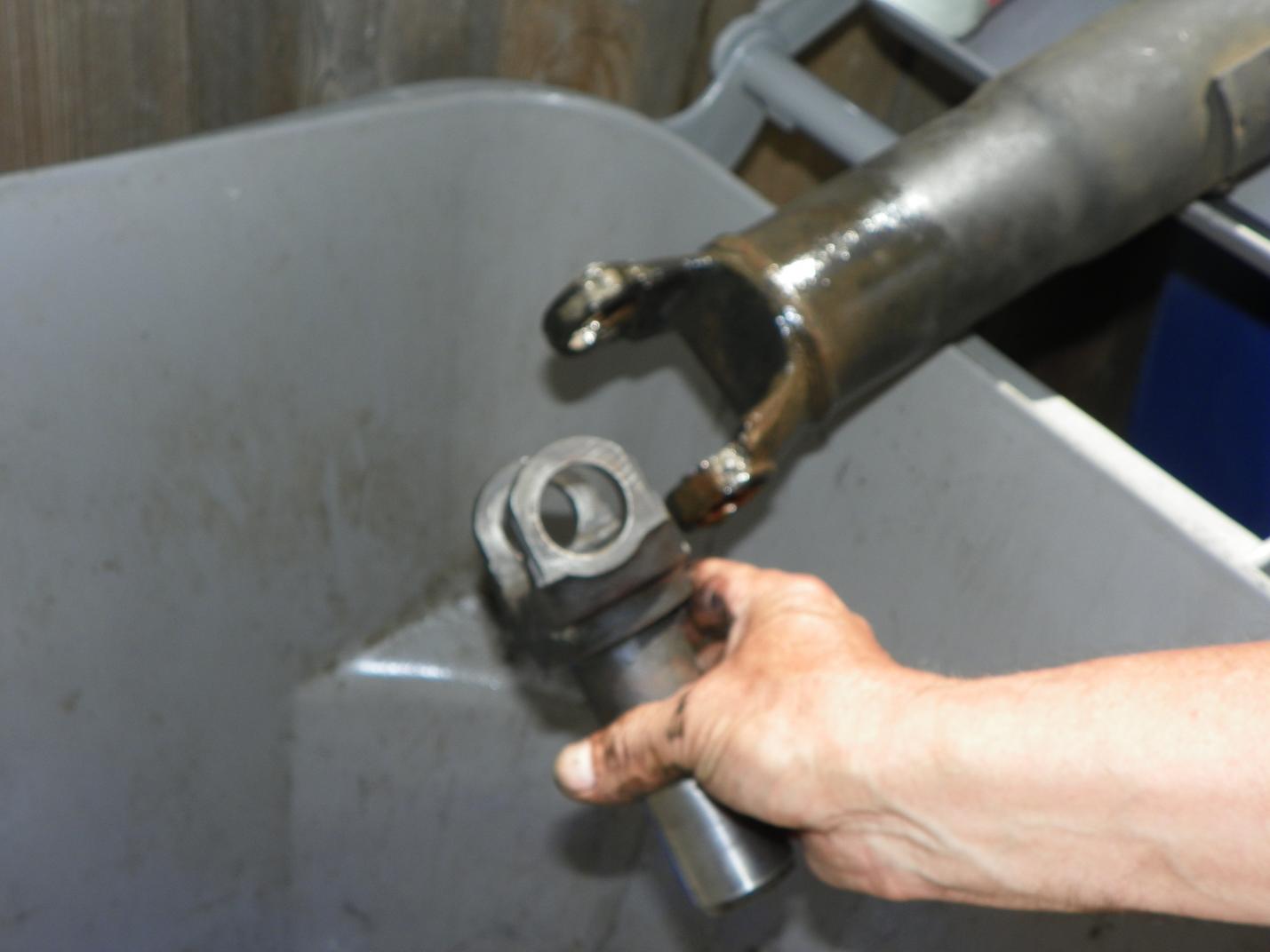

drive shaft pulled out

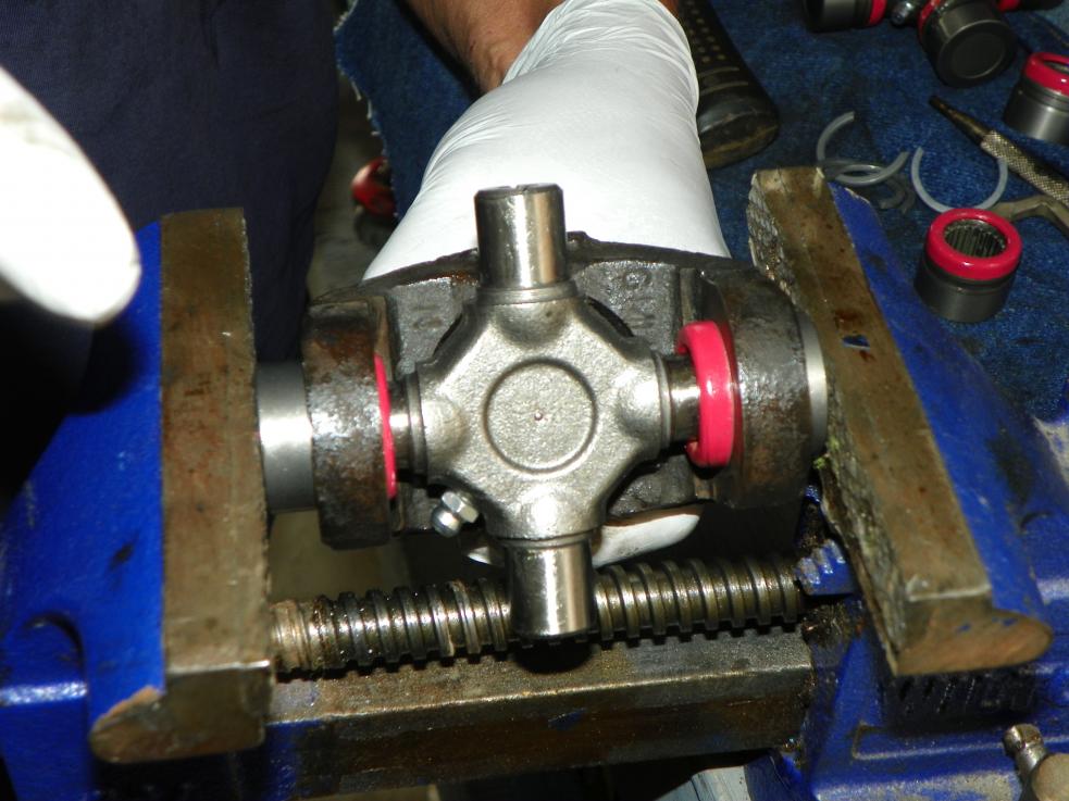

more..
attachment.php

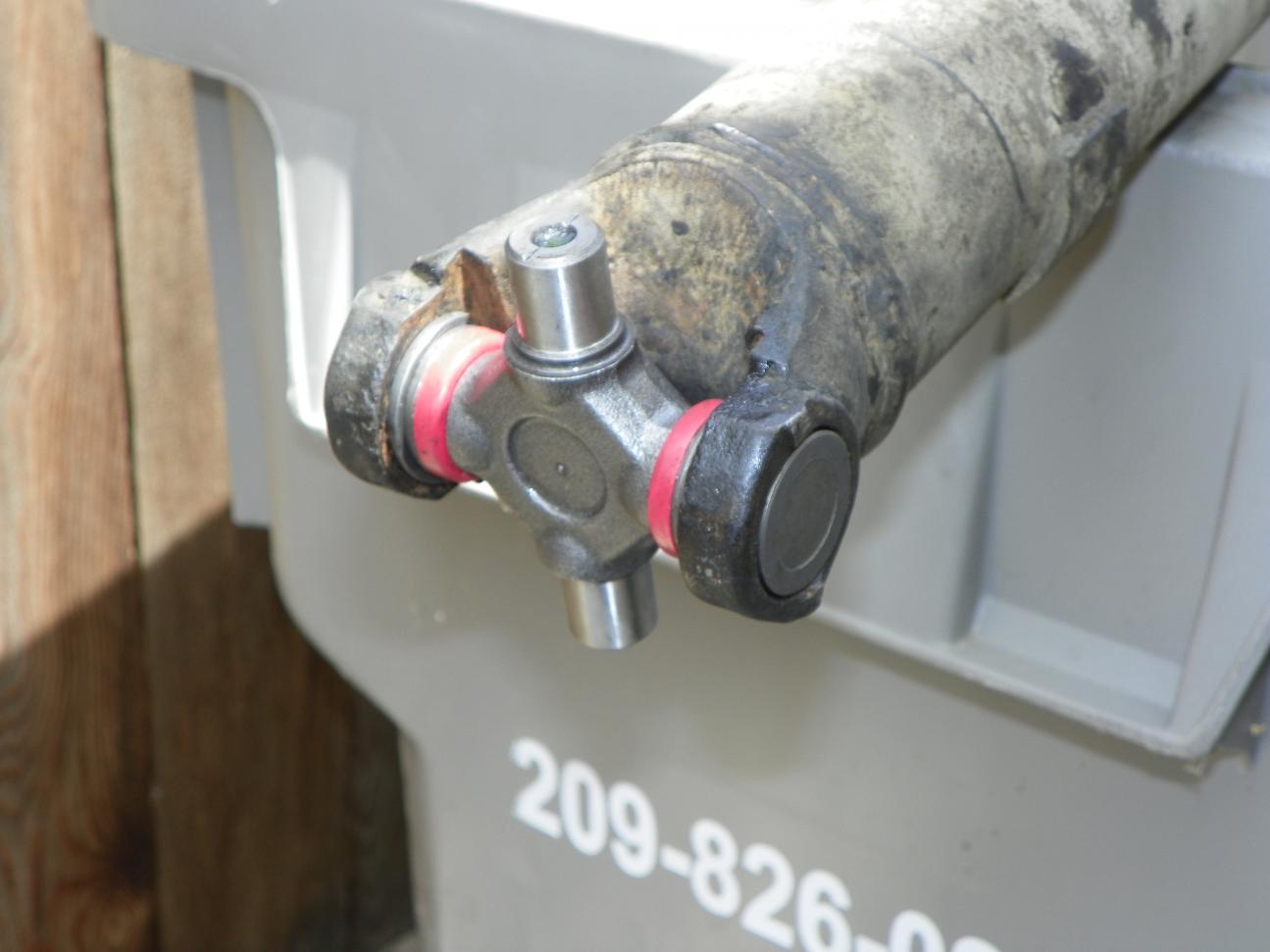

The point is where the factory had poured that hard plastic, to seal the original u-joints, that have to be pressed out to break the seal.

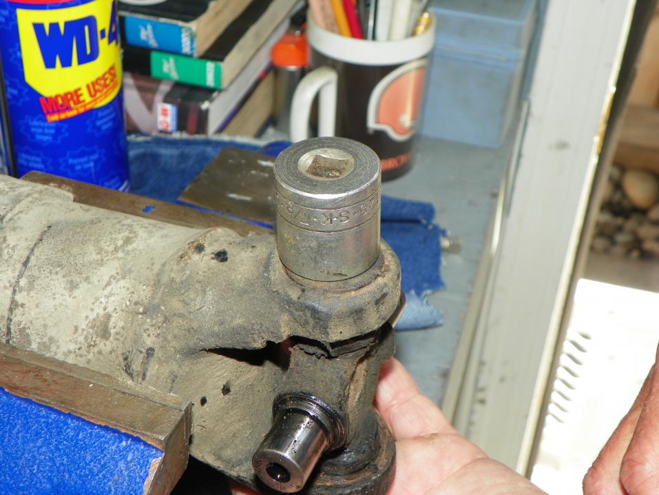

Put my dad's little vise to work today.. it did good
attachment.php

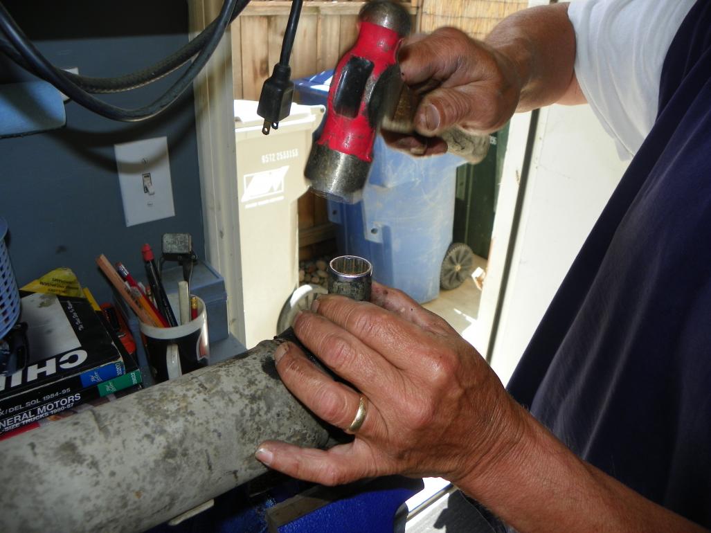

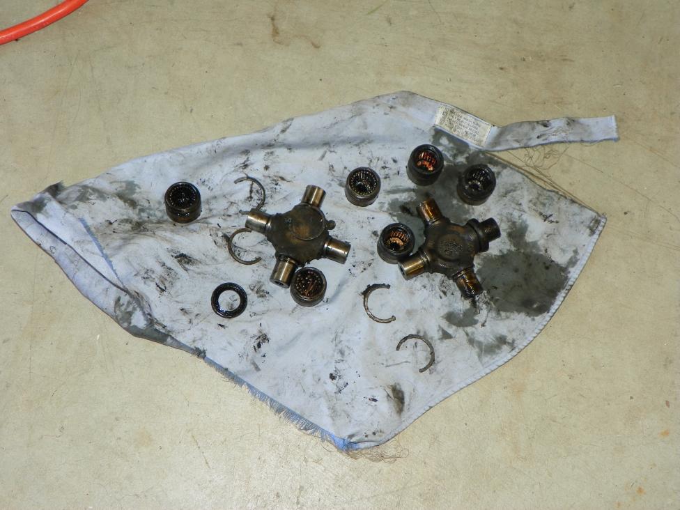

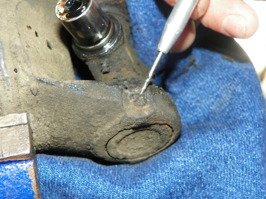

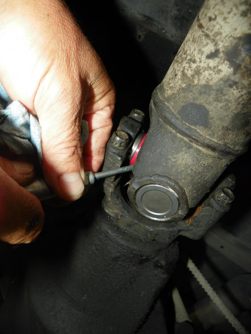

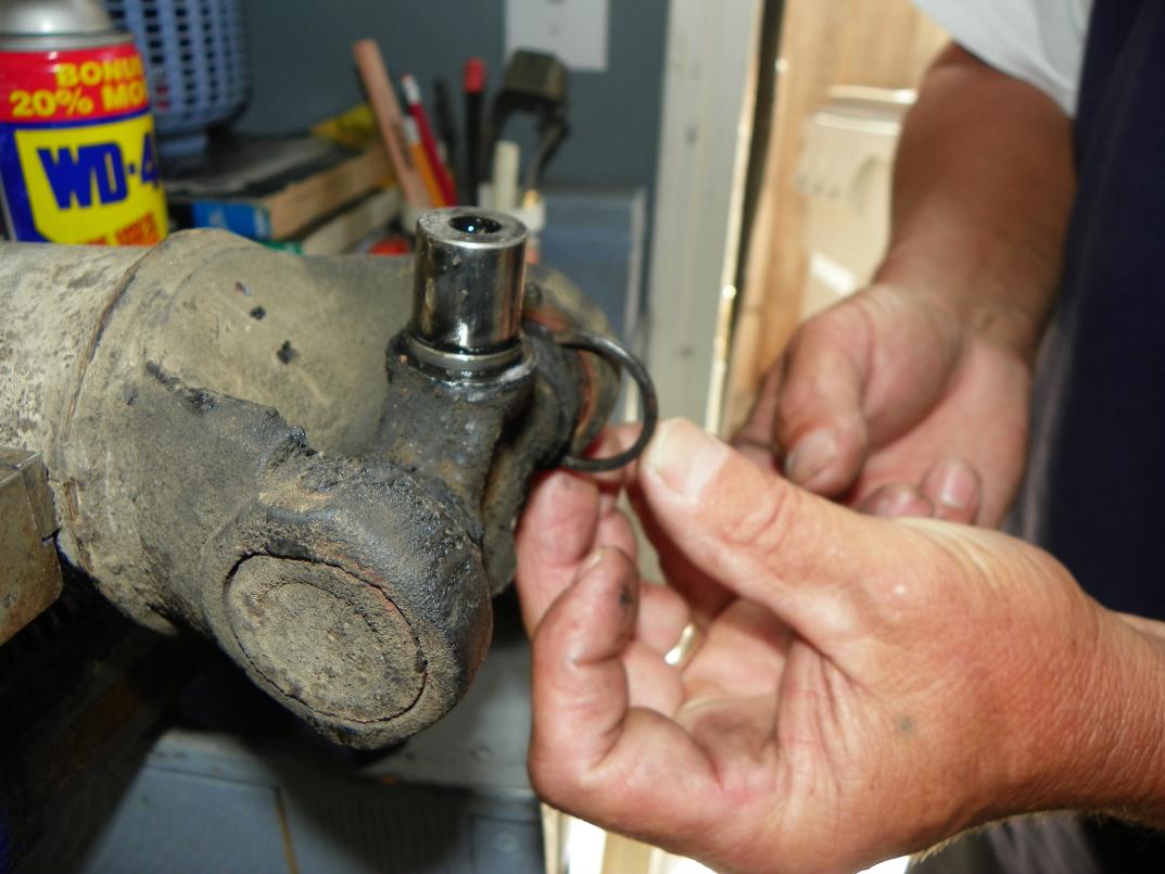

removing the snap-rings
attachment.php

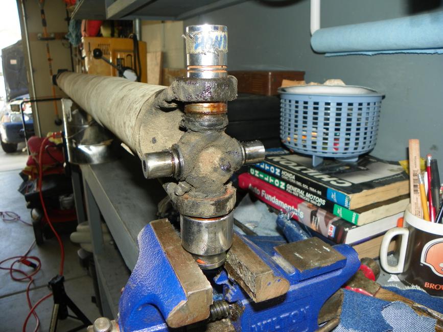

Using the old school method, and punching out the old u-joint with an old socket.
I've seen this on front double cardan joints, I used a drill bit to drill it out, then a propane torch on the yoke (not the joint) to get it apart.

more..
attachment.php

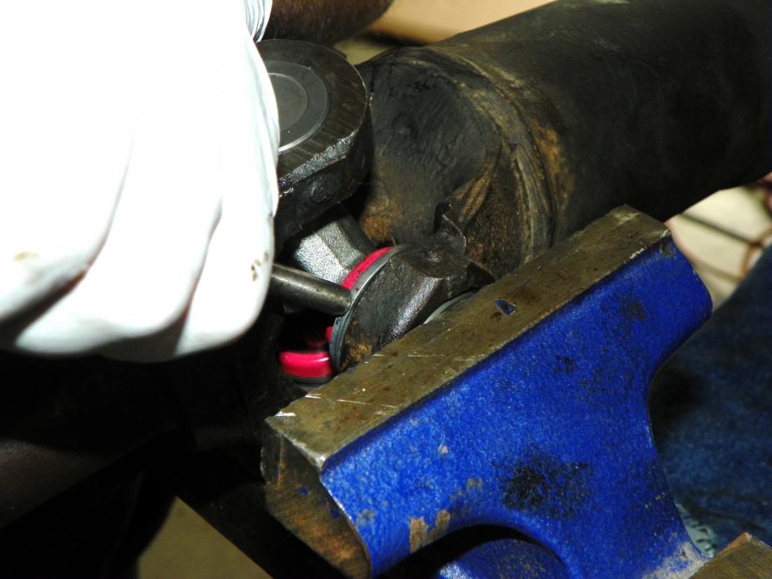

punching it out
attachment.php
you can see how we used a socket bigger than the seal on bottom to hold it firm, and one a little smaller to punch it down, and break it lose..
attachment.php
and.. VOILA!! they're out. pretty much same procedure for front and rear u-joints.
attachment.php
old ones
attachment.php

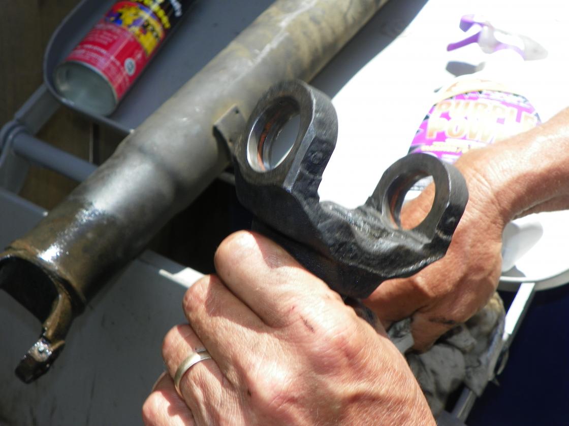

cleaning the old gunk off

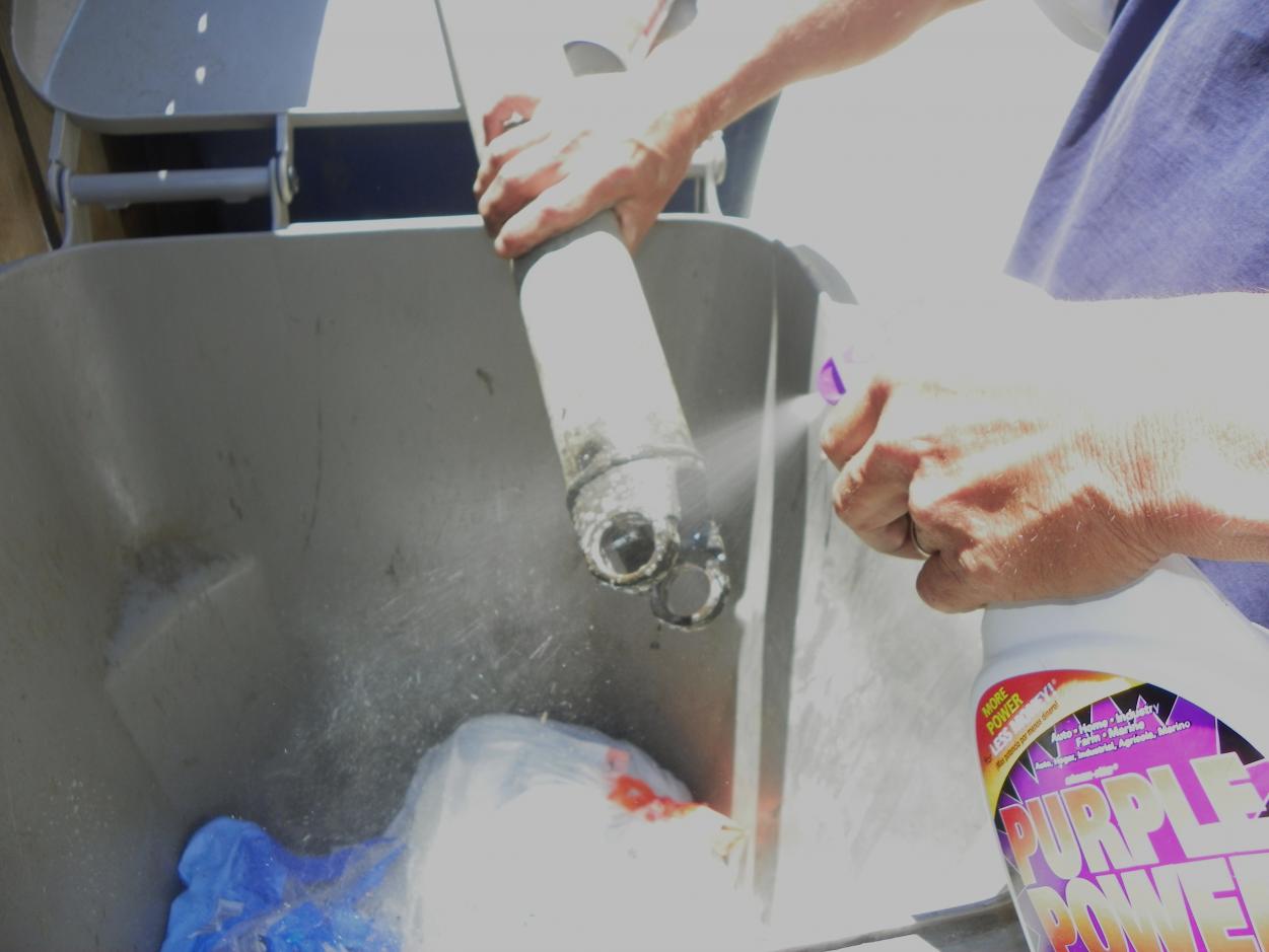

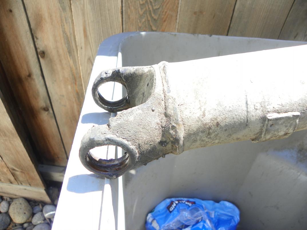

more pix...

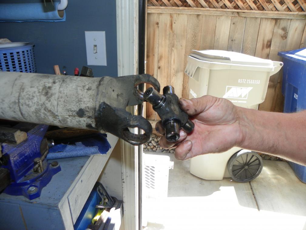

attachment.php
attachment.php
attachment.php
just cleaning up the drive shaft yokes

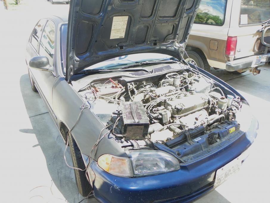

now this is funny, went to jump in my dad's lil Honda,(a.k.a. "Blue Hornet"), to chase some new parts, went to start it up, and NUTTIN!.. he left his lights on, and killed the battery..
That's a fine how do you do!!! LOL

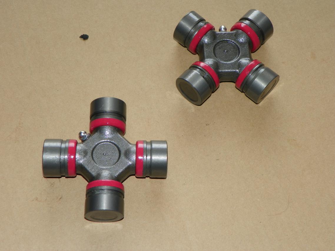

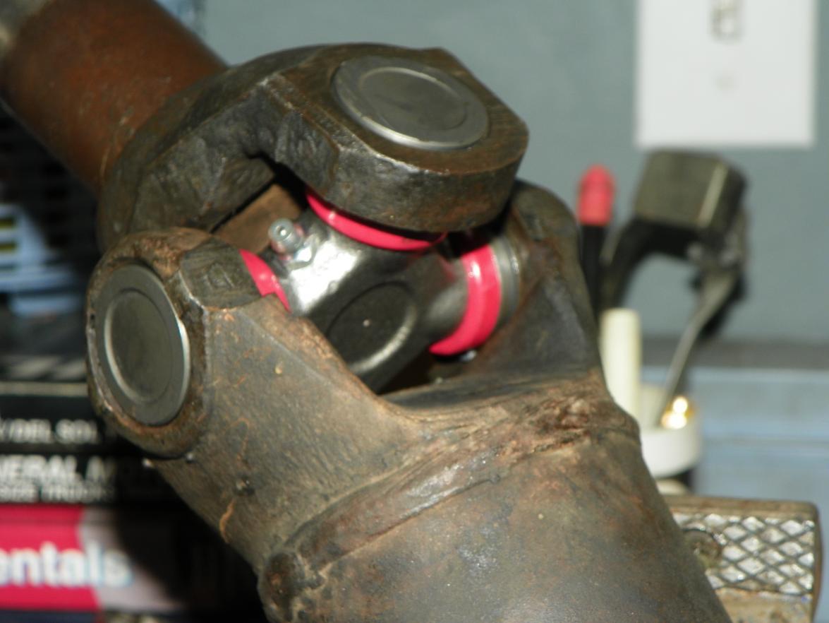

last steps..

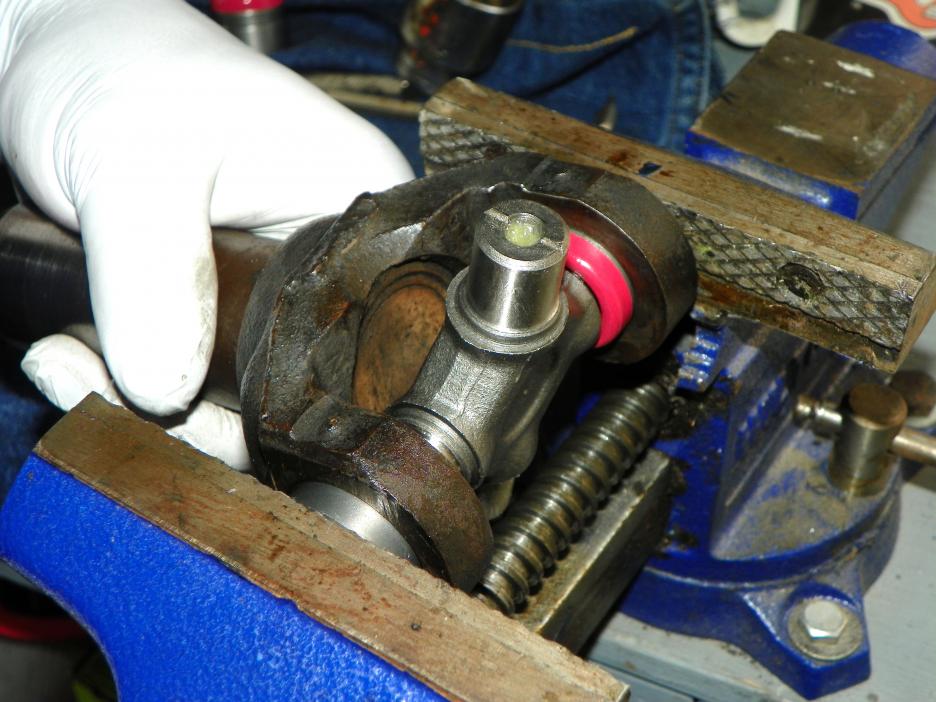

just the opposite of removal..... press em back in

attachment.php
slapped it back in

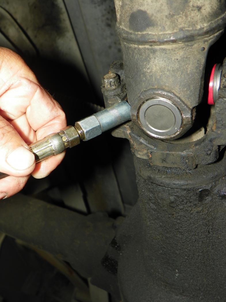

attachment.php

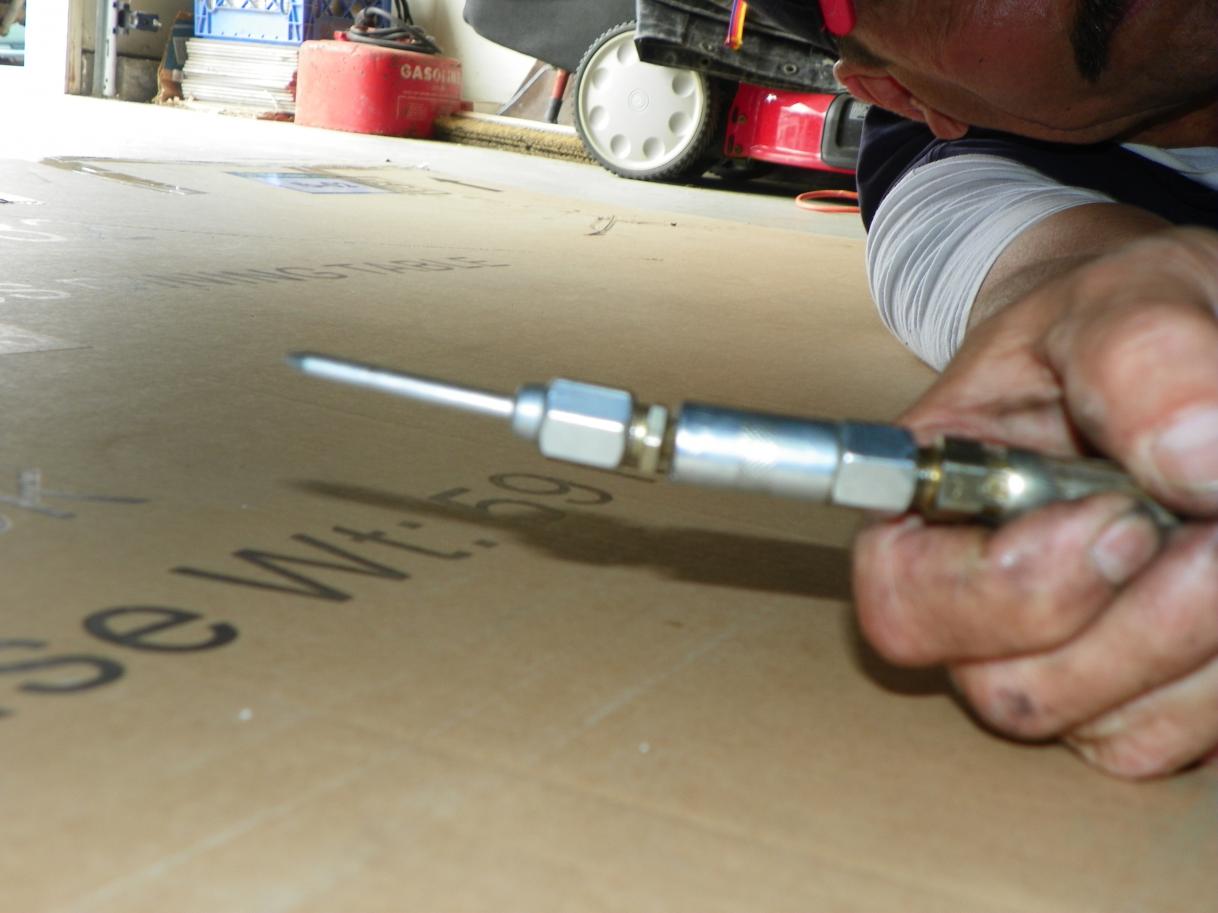

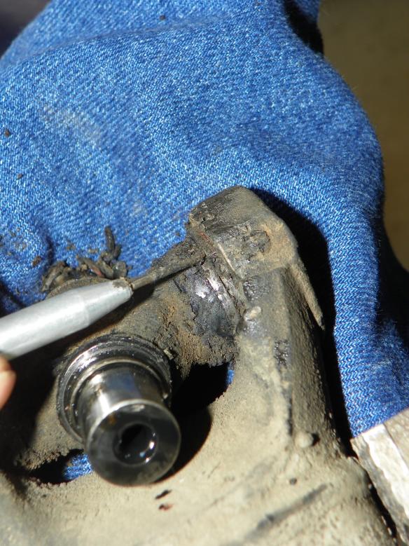

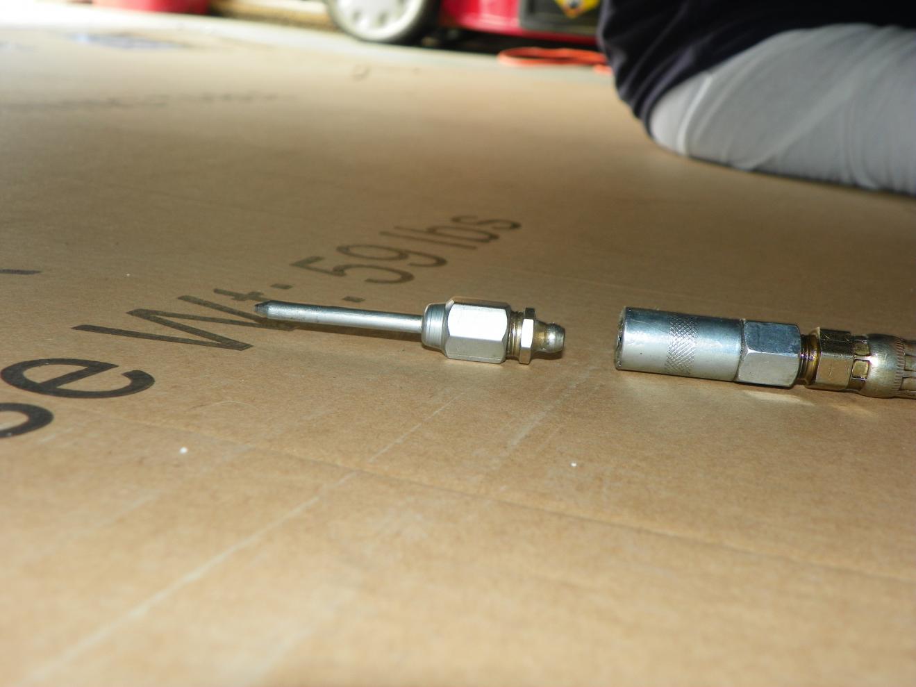

we greased the front u-joints, but the rear one, didn't give us enough space for the grease gun head we had. So my dad had one of these little needles that allowed us to get in there and push into the zerk, and grease it, very handy
attachment.php
attachment.php
you can see how it couldn't fit.
attachment.php
did the trick..
And there you have it.... new U-Joints

One thing to note is the position of the zerk fitting. I cant tell for sure but yours seems to be in the middle of the web, instead of angled more towards one side or another. If the fitting was offset, when setting up your joints to press them in make sure the zerk fitting is pointing in a direction that will make them easy to grease once in the truck. In other words, the rear most u-joint, you don't want the zerk pointing more towards the transmission, it will make it hard to get the grease gun on it. Good job, 'Dude!

Duly noted! Thanks! :handshake:

Nice Job Calidude.Yes sir heat is needed to melt the plastic.When doing the reasembly I use a small barrel roll flapper abrasive wheel on a die grinder to clean everything up,a little lube and the ujoint caps will go in with a small ballpeen hammer.We do this @ the shop especially on the dodge frt diff axle ujoints,they can be a real PITA if not cleaned up real good..PS hows that carb doing? Oh yeah good advice on clocking the zerk fitting for lubing..
