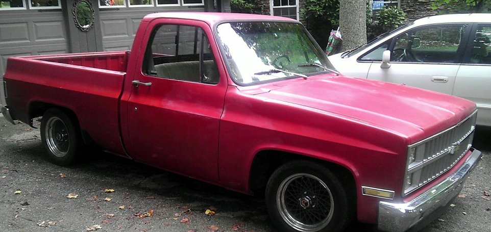

Finally finished. Had to cut the bed supports and remove the rear bump stops. I am super happy with how it came out. Thanks for the help.

Looks great congrats on the finish. What all have you done to the suspension . I like the look and im thinking 2.5/4 on mine

Looks good man I cant wait to install my 4" drop on the rear!
