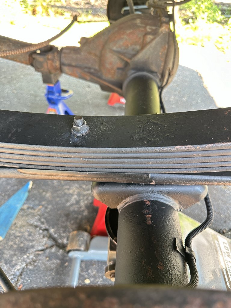

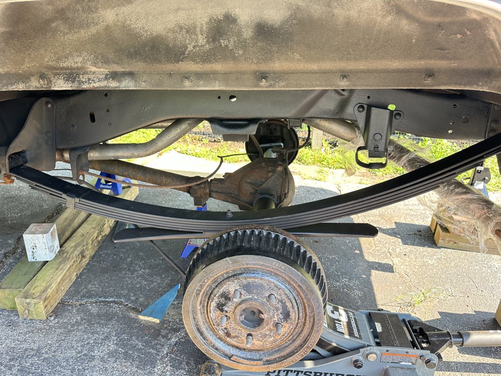

So current issues are:

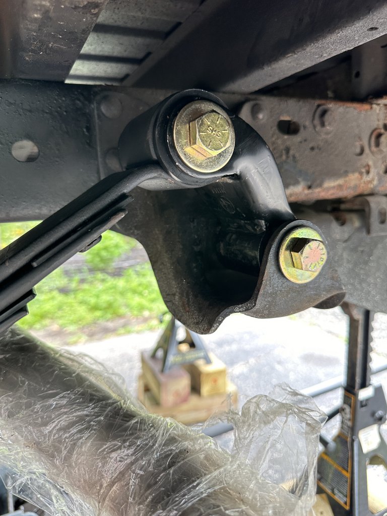

• Is my shackle at the right angle? Seems to me it should be more 90 degrees? It doesn't move, I'd have to somehow take it out and put it back in "straighter" which I am not sure I can.
• The center bolt on the leaf springs is 2.5" away from the bracket on the axle. I am not in the ballpark. Why?
Could I have the leaf springs backwards? They are not symmetrical, one half is shorter than the other. When I removed them I made a note that the 'short' side went towards the front and the long side towards the back. But maybe I am wrong.
Basically I don't know what to do to correct it. Help!

When it's drooped out the axle and shackle move forward. Once you get weight on it it'll be right. Make sure the bolts for the springs aren't tightened up until you get it on the ground or they can bind up

Thank you for that info, helps a lot. The shackle, I looked at photos before I removed, and it's closer to being vertical than slanted forward (like the one I installed). I will adjust it. I just installed the other shackle and made it more vertical. What a royal pain to install.

If you put the same springs back in, in the same direction, nothing is wrong.
Take the driveshaft off, bolt the axle up and set it down. Or just slide the axle forward. From the pics it looks like the axle moved back.
The axle doesn’t move 2.5” front to back in suspension cycling. It’s much less than that.

Thank you for all the tips. Yes the axle had moved the driveshaft back (I had no idea that could happen). I pushed it forward, wrestled with the whole situation in the 90 degree sun for a couple hours, and now the spring is all back together fitting right. I have torqued all the bolts after putting blue permatex. Ran out of steam but in the next day or two I will put the shock absorbers back and install the wheels.
Thanks again! It was a life saver.

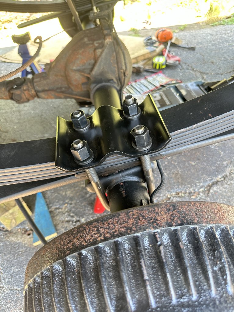

Juan Cano, just looking at your completed setup, looking nice for sure. One thing I noticed, please make sure the axle spring purch is sitting flat with your springs.
Looks like you need to rotate the axle a bit clockwise (pinion shaft end up a bit), as the axle spring purch doesnt look flat with the springs. Just loosen the U bolts and rotate the axle then retorque.
Might be my eyes though! Lol
This is a shot of the springs sitting flat on the purch.
Dude you’re right!
Good catch.
And Juan, after you straighten it up and re torque, re torque it a couple more times after driving it around some.
Lookin good
