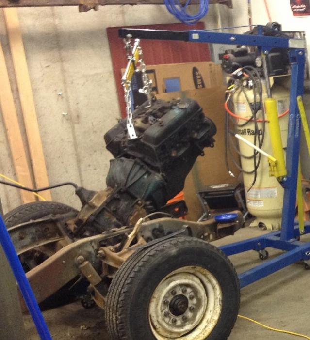

Pulled engine and tranny and cant get them separated. I can manage about a 1-2 inch gap between the engine rear and the tranny. Is there something that needs to be decoupled in the tranny before they'll come apart? Ive worked on a few engines/transmissions before and never had trouble before, but this is comparatively modern. Hints?

lol, nevermind, I knew it would slip apart on its own 5 minutes after I posted this....

Was it in a bind? Looks like it from the photo.

Yea it was in a bind had to be. I do that all day long at work tearing down engines out of wrecked cars and trucks. If you put them in a high angle like that it puts too much pressure on the input shaft and they wont come apart.
Yeah, must have been binding. Hate to think I might have damaged the input shaft by doing that. I thought the opposite - that it would make it easier to slip off. Damn.
