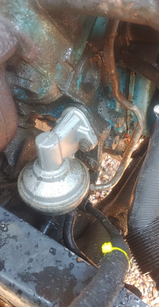

Heres mine
See the top bolt in the back? That maybe is more helpful of a example

I just finally found a thread talking about the significance of that bolt. Sure wish I woulda known that before; that absolutely would have saved me a lot of frustration!

Its a bear to get that pump in there without it, especially if you don't have the engine turned over to where the pump shaft is on the back of the eccentric. You said your budy cranked the engine while you felt the pushrod move?
