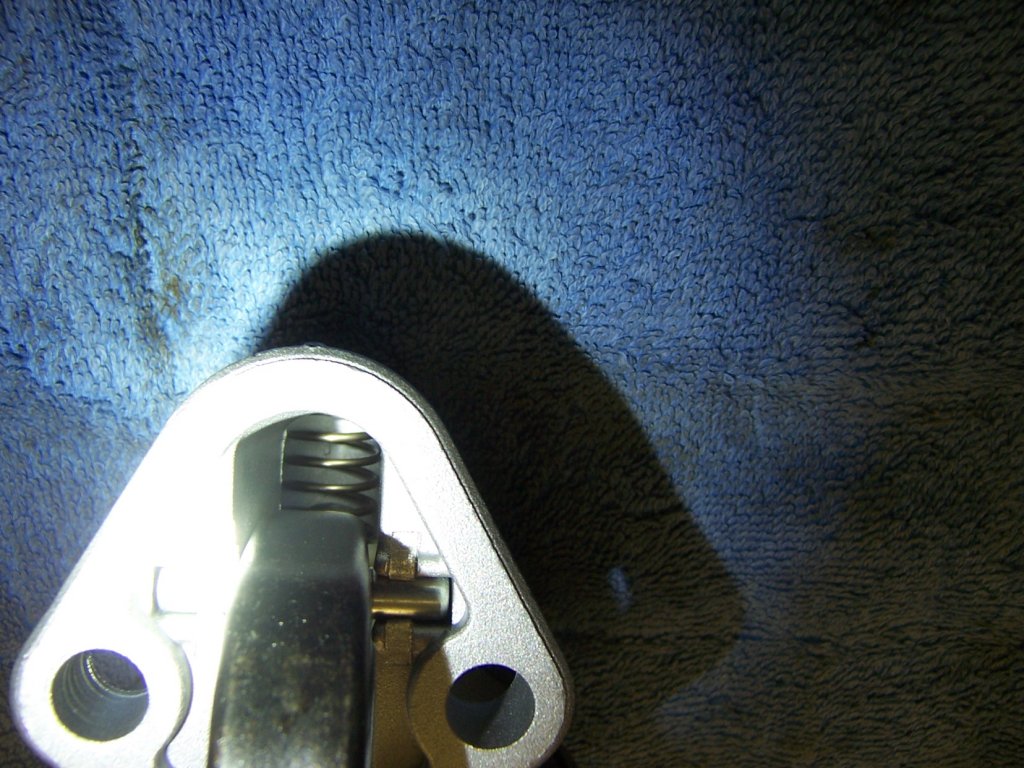

Check fuel pressure and volume. I had 2 new pumps fail in a couple weeks. Both times the fuel pump arms were stuck 1/2 way down. If it ends up being a pump buy one with the return spring on top of the pump arm [see picture] AC, GM or Delphi.

I will check fuel pressure and the new one I got is a Delphi
