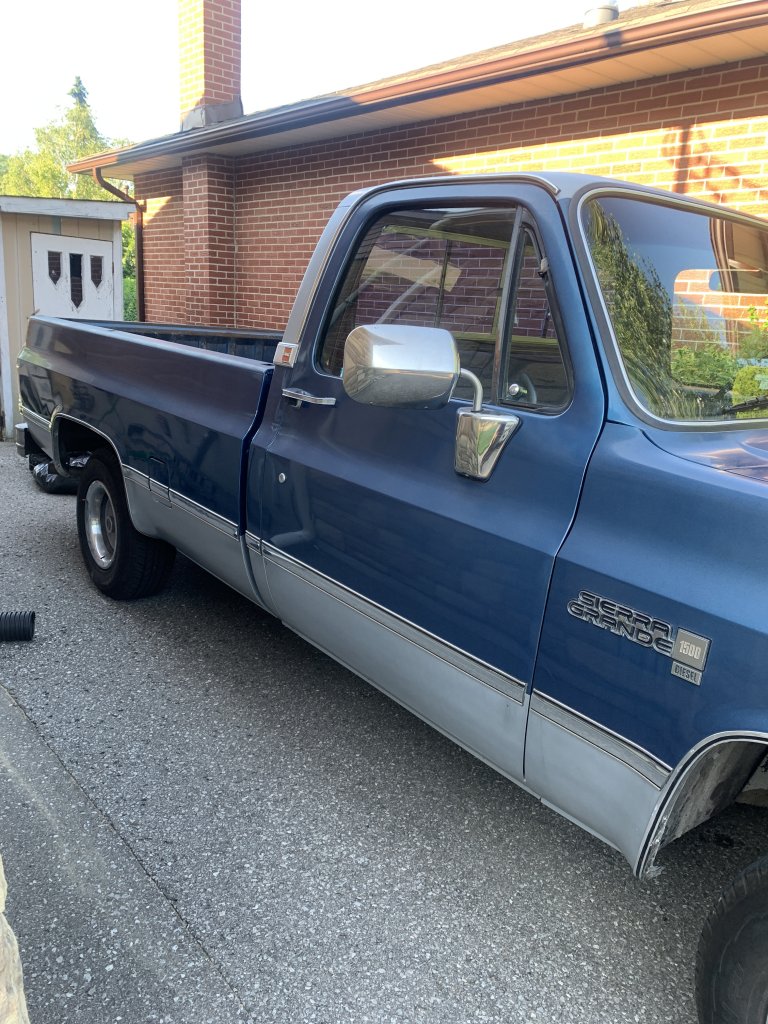

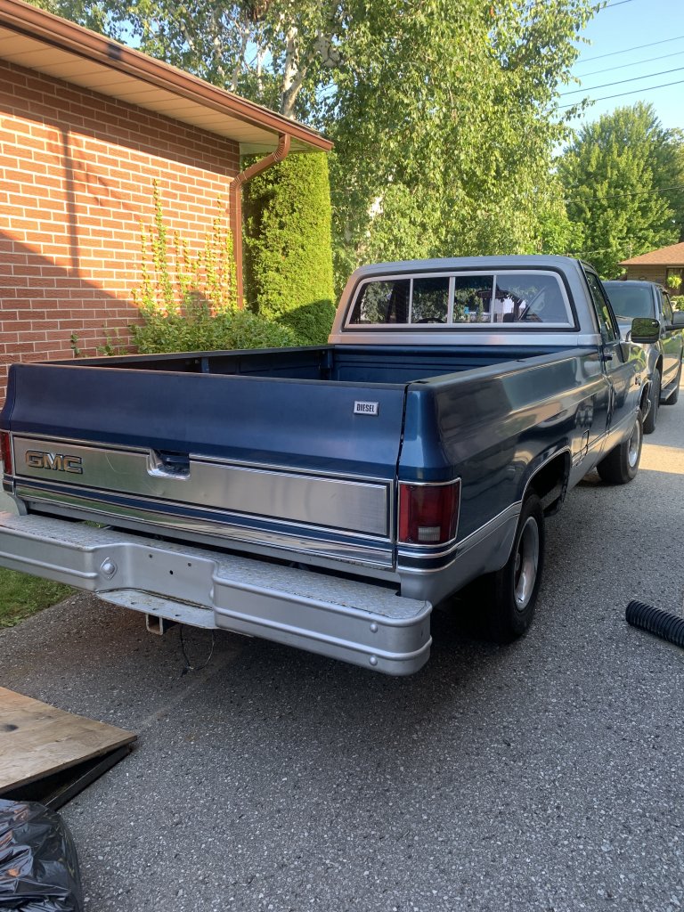

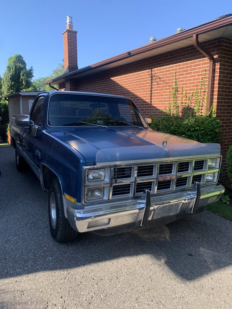

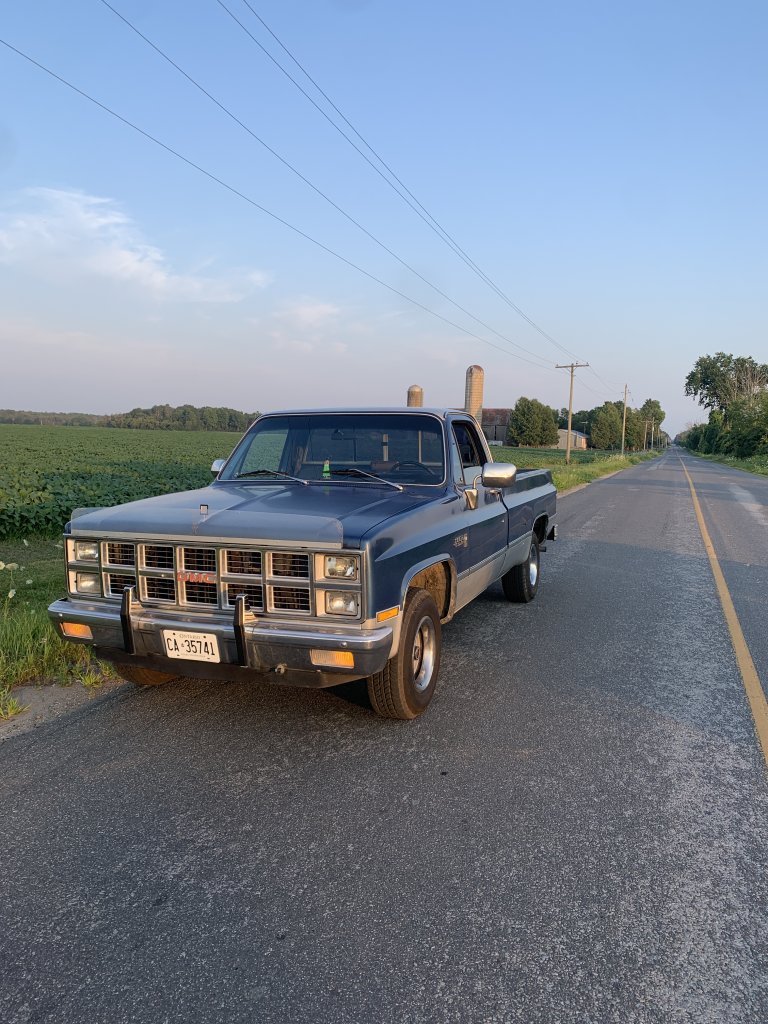

That’s hilarious mine is a loaded sierra grande with all the same options, I only bought mine due to how unique it was and the body was immaculate knowing the how bad the motors could be but was still worth the price I got it for

Nice truck, man! Welcome from Wisco!

Welcome from Austria. Nice truck. Remove diesel, fill up with gas. Done.

Looking back at your pics again that is literally one of the nicest original old squares out there!
