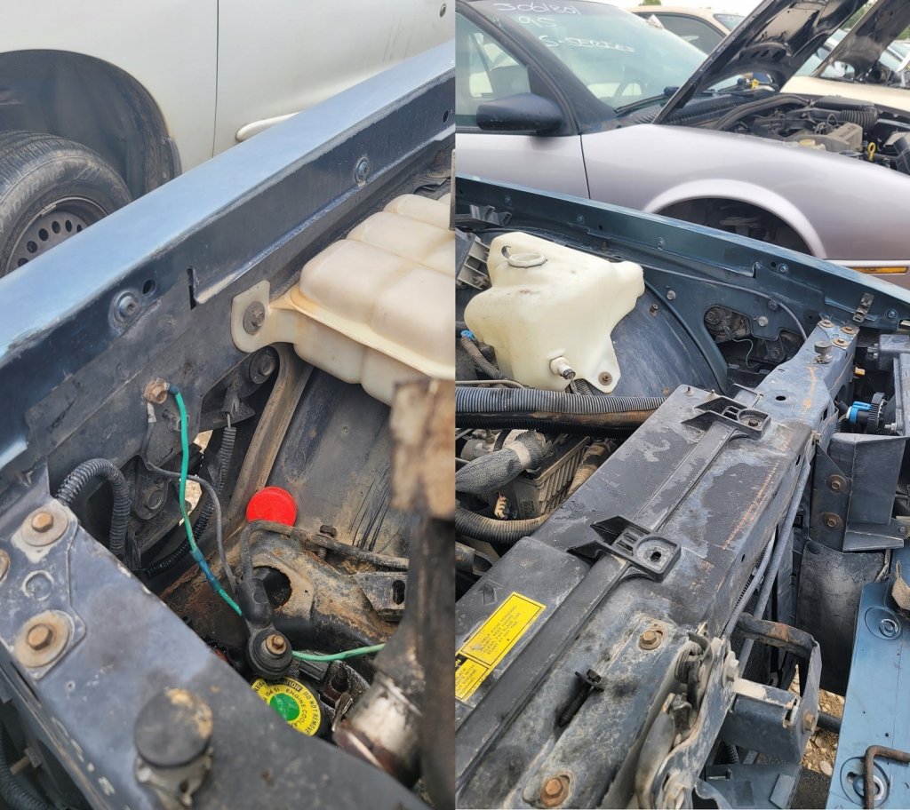

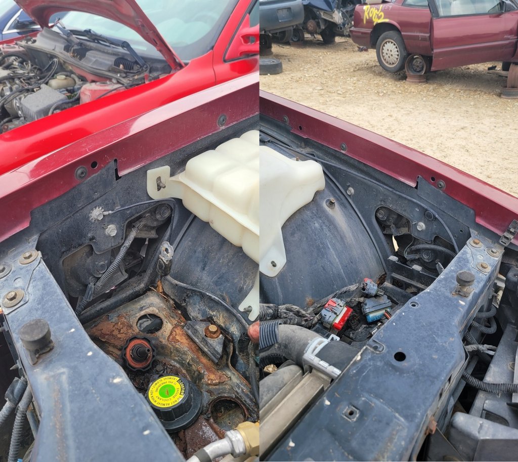

I always forget to wander over to the caddy section at the junkyard. Been wanting the 4 tone horns for the square
Most Caddies from the '80s and '90s were a three-horn setup, low-mid-high. GM still sells the mid tone (but I don't have the part number with me). I installed the mid-tone on my '67 Olds 98 13 years ago.
