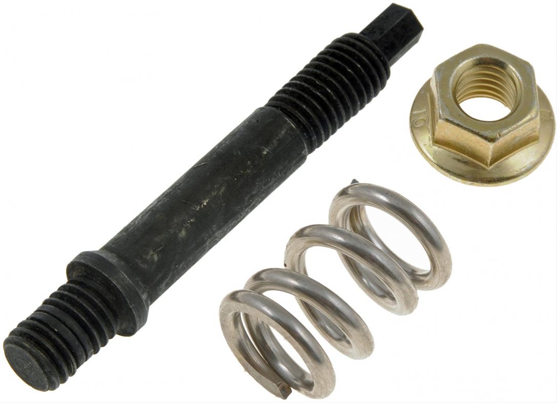

While I was disassembling my truck exhaust to remove the engine, I had all 3 studs twist off on the driver's side. I have been soaking them with Knock'r Loose for the last 4 days and tapping with a hammer. Last night I decided it was time to tackle swapping the news studs in. I didn't use heat. On the broken studs I decided to use my Porter Cable impact screwdriver. I cut a slot in the studs wide enough to get the flat bit in, and deep enough to get a good bite. The first one backed right out. Second one I should have tried tightening first and then backing it out. Busted both bits I had. Third one I used vice grips and tightened it first then started walking it back and forth and adding Knock'r Loose as I progressed.
The passenger side all came out with a small pipe wrench with the tighten first and then loosen method.
I need to get an easy out for the other because stupid me decided to cut it off flush. I should have got more bits and used the impact because it worked so well. Just the cheap-made China bits couldn't hold up. Lesson learned.

If I had just cut them off, drilled and tapped them, it would have taken less physical time. But with the soaking of Knock'r Loose multiple times for 4 days, they turned pretty easy considering they were frozen in rust. I just screwed up with the second one expecting it to buzz out like the first one did. I couldn't find my center punch, so I used the most pointy punch I had. Unfortunately it didn't leave a good enough guide for the small drill bit, and the bit walked a little off center. I stepped it up one size at a time until I got close to the threads, then I stopped. During lunch today I will get a tap and some extractors.
I never used anti-seize until I started working on the engine this rime around and finding so many nuts and bolts frozen. So the water pump bolts got some, the exhaust studs, and the exhaust nuts on the studs as well as the bolts into the head will too. I am getting wiser in my middle age years.

That is why I sprayed Knock'r Loose on them for so many days in a row. I just didn't want to do them and knew they would break loose easier if I did. I need to get my rig back on the road, so there's that.
Are you talking about a spring on the passenger side? I don't recall seeing any spring(s) on the driver's side.

I cannot envision a spring on the driver's side exhaust.
I have springs on all bolts on both sides. Maybe something they did in my model year. I'll throw some pics up when I take them.
Oh...those half-moon shaped things with three tabs on each end to hold the bolt heads in place? Yes, now I know what you're talking about. I have those on mine too, but the tabs were never bent so they're ornamental on my setup...:)
