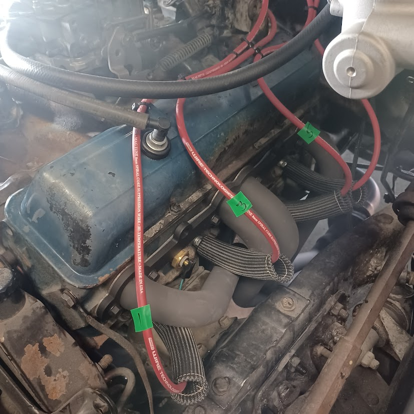

#1 on a Chebby is drivers side front.
What you have labeled as #6 should be your #1, going clockwise from there 18436572.

drivers side labeled correctly?

Rikko,
If you can see that vacumn line I USED to have....thats where is should land on the carb from the distributor correct?
vacuum hose has blue painters tape on it

I am thinking the same thing. but you guys on here know more than i do. I was told to check firing order...so I am just trying to confirm that its all correct. I will label stuff more permanently later.
Just trying to figure out the misfire and learn WHY....

this engine will run fine in park and when you rev it up but when you start driving is when I have the backfire/misfire crappy stuff happening.

I hold to my original post, I think you should put the vacuum hose back in place and fire it up...then drive it and see if it still manifests the issue.

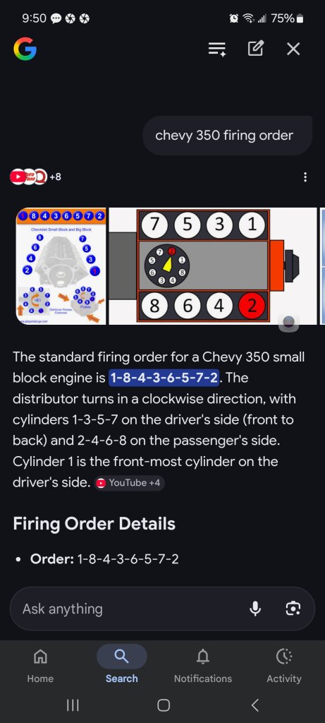

He's got drivers side and passenger side flipped.Ill see if I can him a pic. Brb
