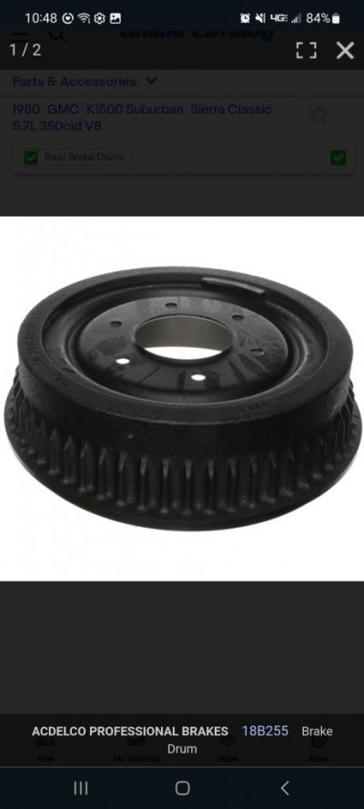

no, my 3/4 ton is a 1980, which is 8 lug , and it has the large 13 inch drums for the 14 bolt axle
The drum in your picture, is 5 lug, I have a 5 lug drum like it on a scrap pile
I doubt there will be anything significant learned from checking for a lip, but id guess the drum is OEM because of the similaritieis here(this drum was likely taken off a truck in the 80s or 90s)
6 lug is mine. K10

A small spacer would solve your problem, but use longer studs to be safe. Those rims must be made to fit a different style drum.

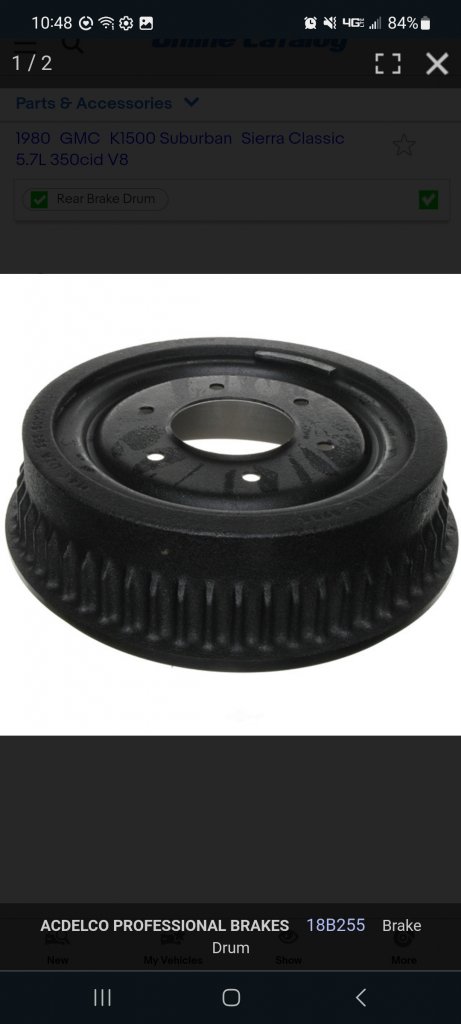

I wonder if a drum like this would work? Or cheaper to have my surface lip machined down?

Take a wheel and a drum to your local fab shop. Let them have a look. Take one of your factory wheels as well for comparison. I won't cost you anything to have them look at it and you do not want to machine down your factory drums. Buying different drums without test fitting will very likely reveal the same issue because it's the aftermarket wheel center that is different from the factory wheel center.
This drum appears to have the same lip, looks like the two notches are the only difference.
