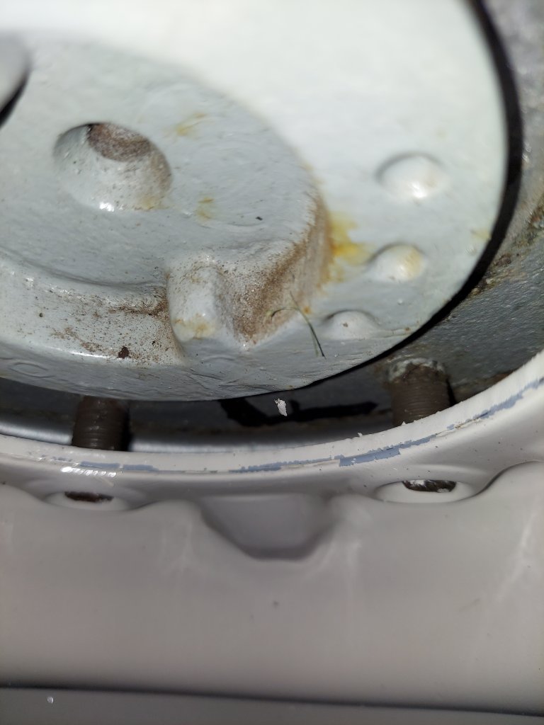

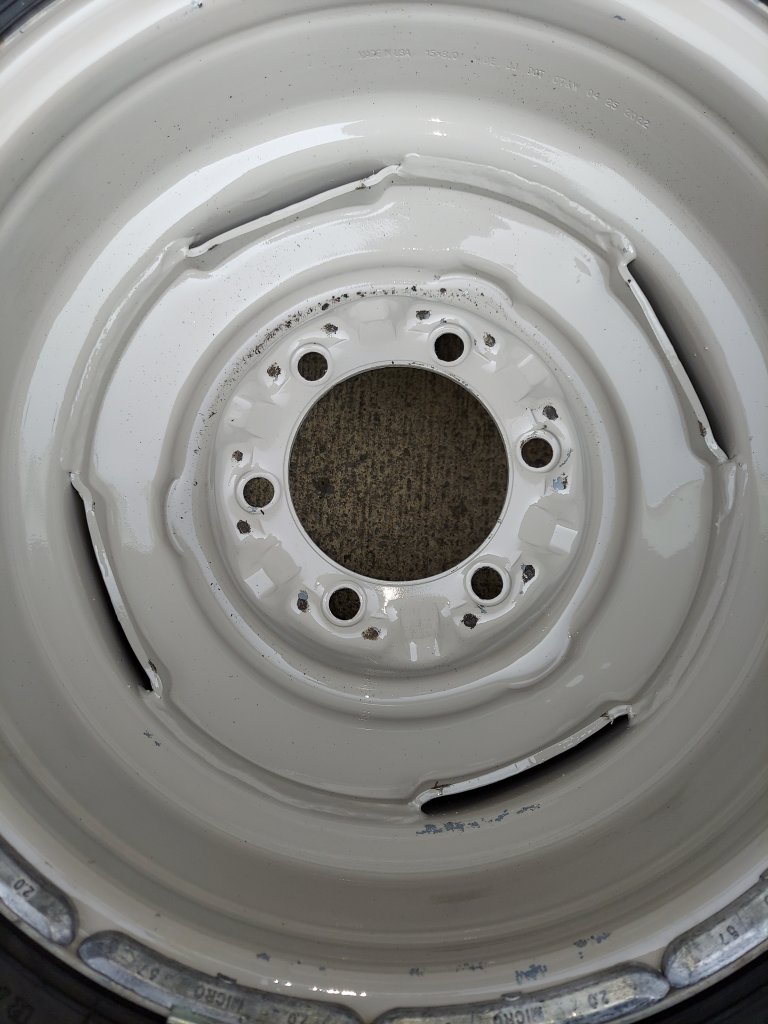

Looks like you are putting them on backwards or the centers are welded in wrong.
Pictured is the inner part of the rim. Outer lips of drum is interfering with raised lips inside of the rim. You can see the paint scratched off on the edges. I agree they're fabricated incorrectly.

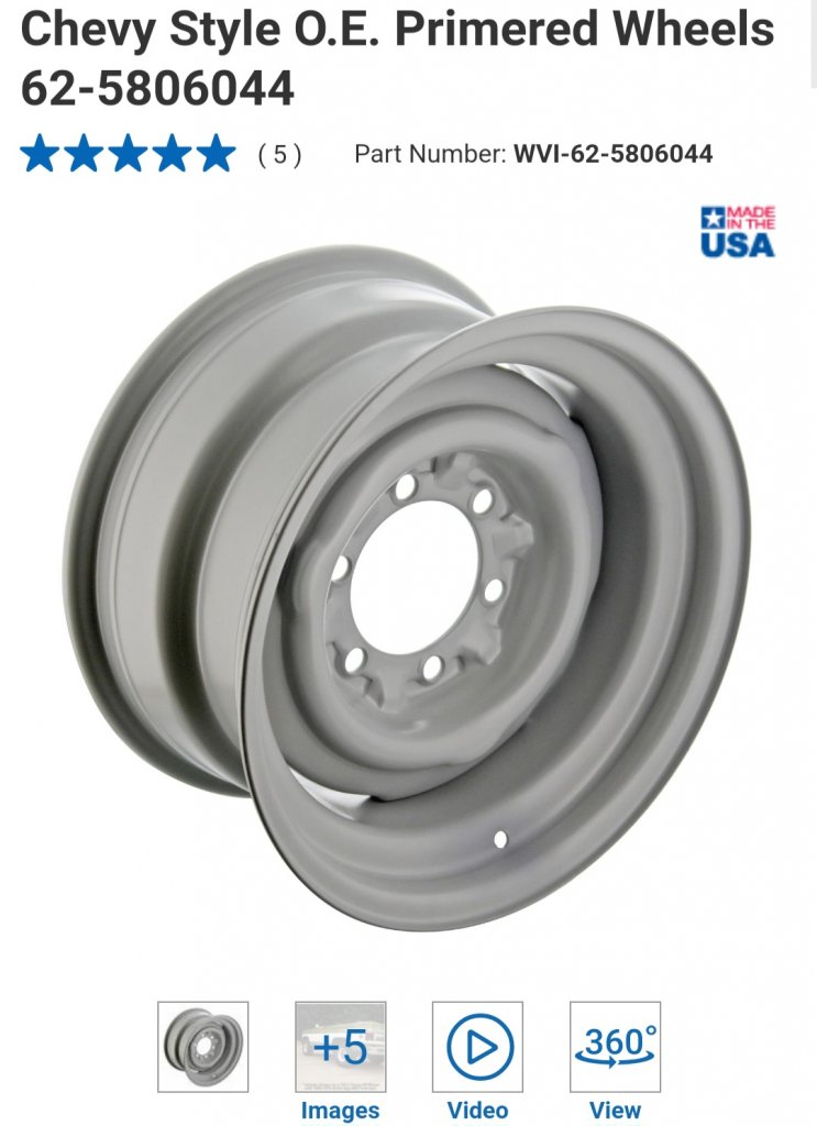

Did you look it up on wheel Vintiques? Because I can’t find the exact wheel you show from Summit.
But the closest 2 are a 62-5706044 which is a 15x7 and says 1950-60s Chevy /Ford. And a 62-580604 which says pre 1971.
Without finding WV with the same part number it may be a discontinued model but points to not being applicable to 70s-80s GM K10s.
I’d say they’re fabricated just fine and if Summit listed as fitting a K10 square they are wrong in their application chart.
Too bad you painted them before test fitting? Or another clue if they came painted as the closest WV wheels I found were only offered in primer.

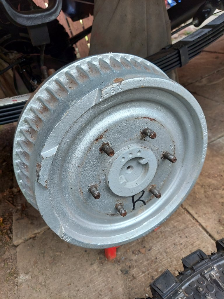

Working at a shop that sells tires we see wheel interference problems almost daily. Know the horse has left the barnyard but always check fit first. Modern production tries to consolidate part numbers. Is it possible drum is not the same as OEM? Although not recommended spacers may be the only option.

^Great point. While the wheels point to wrong application, have you looked at drums to see if there are some without that lip?
I have seen a couple brands like Raybestos and the lip is lower. I have not gone shopping as I have used rims I have been wheeling around on I can use. I need to get tires changed over so I can drive and enjoy it for now.
It's possible. GM#: 359493 is stamped on the lip of the drum that's interfering. I assumed it's the proper one? I thought I was clear with going OE style but clearly I am wrong here. Ugh!!
