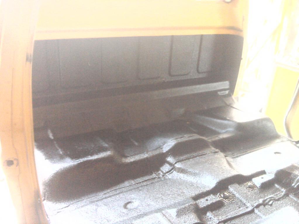

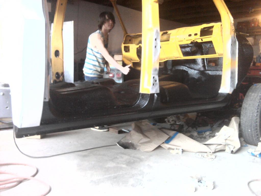

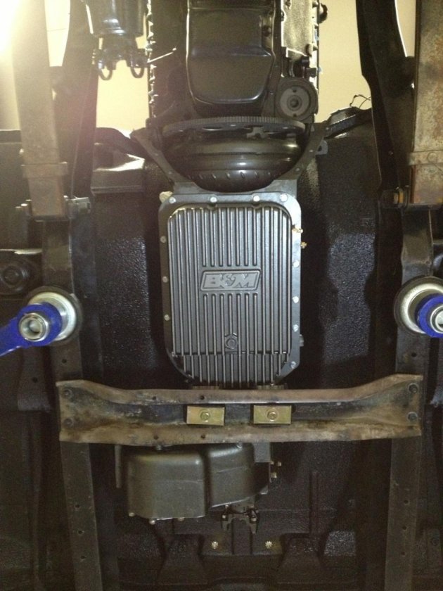

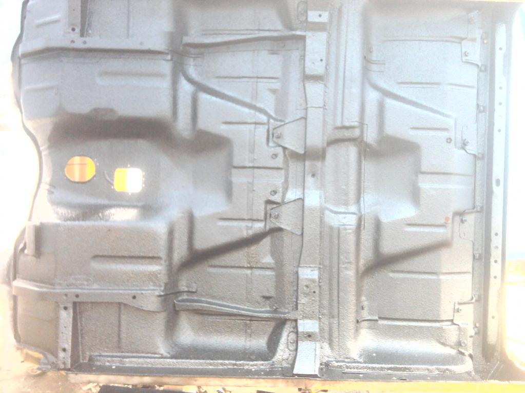

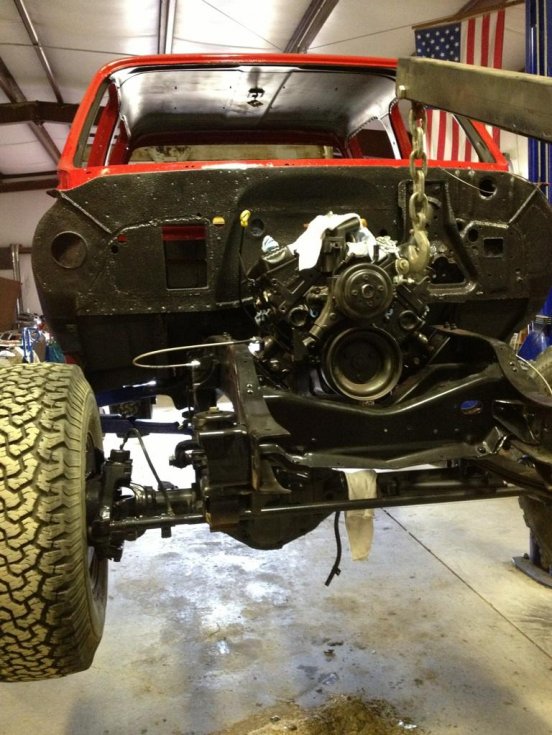

look at monstaliner its a diy roll on bed liner
I sprayed it on my crew cab under the cab on the firewall and inside on the floor and up the firewall and back of the cab
it looks a lot like rhinoliner
I have more pics and how I done it in my build thread there is a link at the bottom of my posts to it
