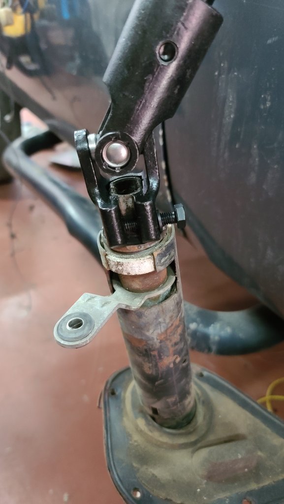

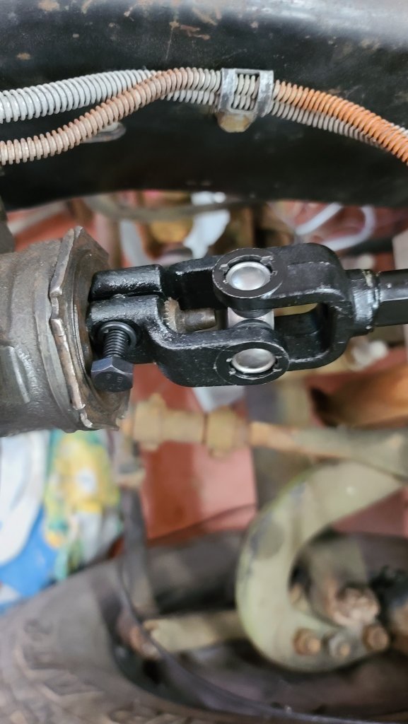

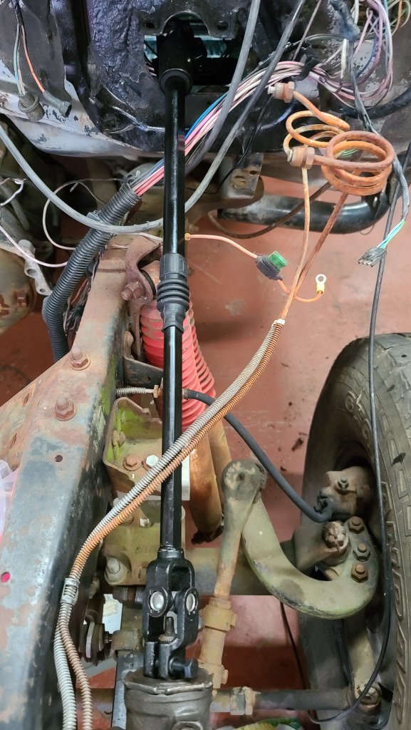

OK, for those of you wanting to know if the 87-95 Jeep Wrangler shaft will work...Yes with some shorting...It is longer than the Cherokee Shaft. I have taken a few pics, just to show anyone interested it will work with some minor modification. When I put my column back in, I'm also going to do a write up and take lots of pics on how to shorten your Steering column.
