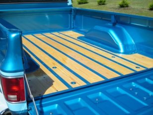

I'm thinking of doing away with the bed floor and doing a wood bed, seems to be an easier job!
The truck in that picture has the factory optional wood floor, and the owner of it spent a considerable amount of time making it look good like that again.
Looks beautiful!
That's a 73-80 E81 fleetside. I've seen that restoration and it's gorgeous.
It was a heckuva lot of work. Not easier than a steel floor. There's a thread about it on the 47-Current Chevy truck forum. Here ---> http://67-72chevytrucks.com/vboard/showthread.php?t=432498
The side flanges and cross rails are not reproduced by Mar-K or anyone else... Mar-K makes the wood and interlocking strips. He had to take the rusty original side flanges to a sheet metal shop and get one off reproductions. The under wood cross rails and rear crossrail are modified from reproductions for the 67-72 E81 bed. Lot's of fab work and fussy detail. Stunning results.
My grandfather made wood plank deck beds with 4x8 rails and 4x4 notched crossrails for 4 of these trucks. It took two afternoons and they looked good. The lighting, fuel filler mounts and, mud flaps took another afternoon.
