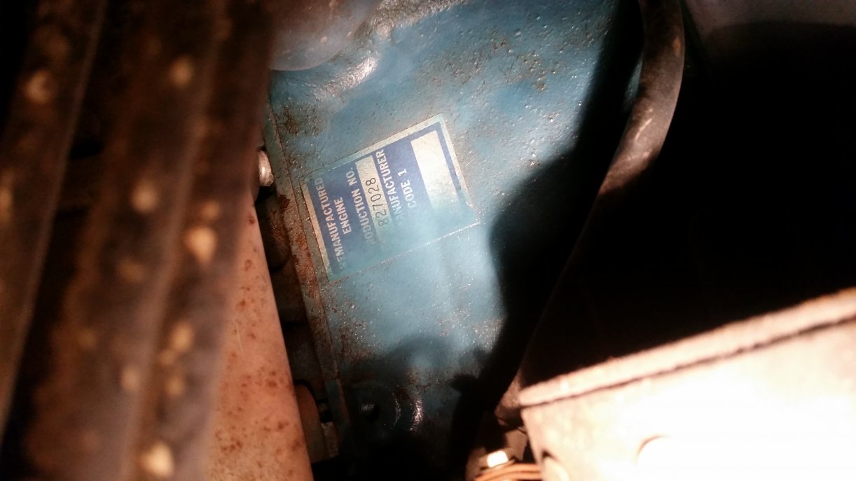

Greetings!
A friend of mine has an '84 C10 that he bought from his uncle. Long story short, his uncle swapped in a 350 in the early 2000s but doesn't have the paperwork or anything from that time. We found the block casting number and it's 3970010... which could be anything... But we did find this! (See attached picture) It says "Remanufactured Engine, Production Number 827028, Remanufacturer Code 1" This is on the passenger side of the engine below the exhaust manifold in front of the starter (as shown).
The plate behind the alternator has been milled clean so no help there. :whymewhyme: Anybody know what the heck this means? What kind of HP or figures this engine has? Would be super helpful.
Thanks!

That really means nothing unless you know the re manufactuer who built it. I have something similar on my remanned crate 454 that I bought too. Could have been a big company like Jasper who rebuilt it. Mine has a similar sticker with a 7-10 digit production # on the left side under the exhaust manifold with an Overheat snitch plug in the freeze plug that voids the warranty if it's popped. So far, it's never overheated since being rebuilt.

So assuming it was Jasper who rebuilt it - although it could have been anybody - would we just go to their website and try to look it up? Or call them? Certainly there is an online database with this kind of info in it.

I'm curious why you are trying to find this information honestly. Its most likely a run of the mill 350 and if it was rebuilt then it was probably bored over .30 which is fairly common.

All I'm trying to get at is you have a run of the mill sbc 350 block. There really isn't much more to know. You could check the numbers on the heads or pull the heads entirely and measure the bore if you want more data.

The 3970010 block is a good one! Has more nickel content then other blocks. It was produced from 1968-1979. It was available in 2 & 4 bolt mains. It came in car, truck and Corvette. This block is said to have very straight main journals because of the higher nickel content. It came factory in 185/370 HP configurations.
I just so happen to have one stuffed away in the corner of my garage for a future build.
The head casting # can be found by removing the valve cover.
Here is a link to the info once you have your head casting #
http://www.73-87.com/chevy_ids/sbcid2.htm

I agree it's going to be the average run of the mil rebuild. The # is more for warranty purposes than anything and if it's out of warranty by now which likely is, the remanufactuer won't give 2 ***** about giving up any info. Chances are it's Silvolite .030 or .040 pistons, with .010 or .020 mains and/or rods with stock remanned heads.
As far as the 3970010 myth and high nickel, I don't buy that ******** myself. Especially for as long as that block was produced. A 68-72 block I might buy into some of it, but nickel content was cut down year after year. 3970010 is just that, a CASTING #. The # to the mold, not a thing to do with the melecular structure of the block build. I wish I had known so many people drank the Kool-Aid and bought into that ********. You know how many 3970010 blocks I've scrapped? And they were virigins. Most common 350 Cast # built. I could be a millionaire selling HIGH NICKEL blocks by now.

As far as the OP's question. The 350 that were standard on these trucks back in the day were rated 185 hp to 195hp IIRC back in the late 70's. Since this is a remanned engine I would assume a low hp rating and then be surprised if it has a slight cam in it.

My point behind the 370HP Corvette model was that the block is not a waste unless of course its broken! Aside from pistons, the heads is what makes power. So clean up the block and throw some flat tops, a cam and vortecs on it and wow! Not a bad little engine. That's my plan anyways.

Alright glad to hear some of the history behind these blocks. He has an "RV" cam in it and stock heads as far as I know. I don't think he's ever had it on a dyno. So the block will accept L31 heads? The vortecs? If so there's a set local on Craigslist that have just been rebuilt for like $400 that might be a good investment.
