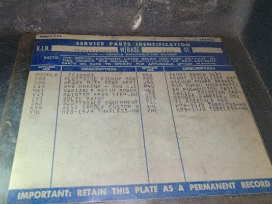

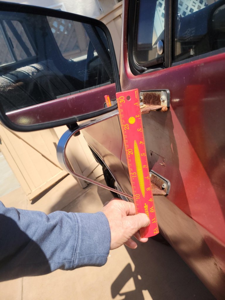

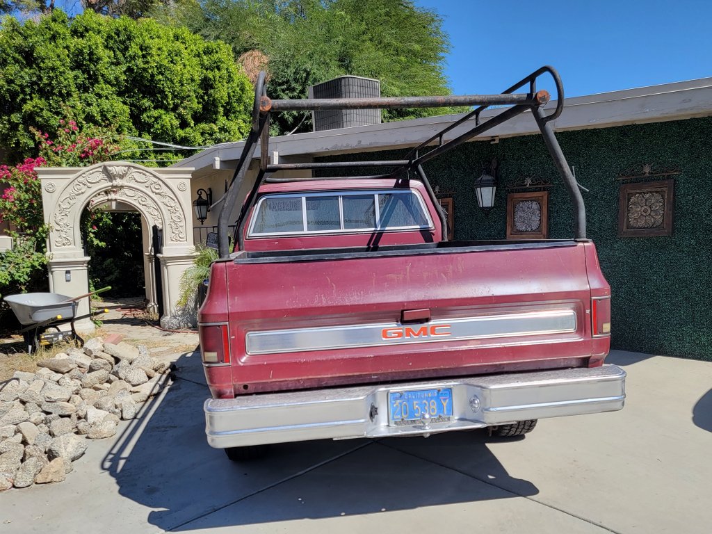

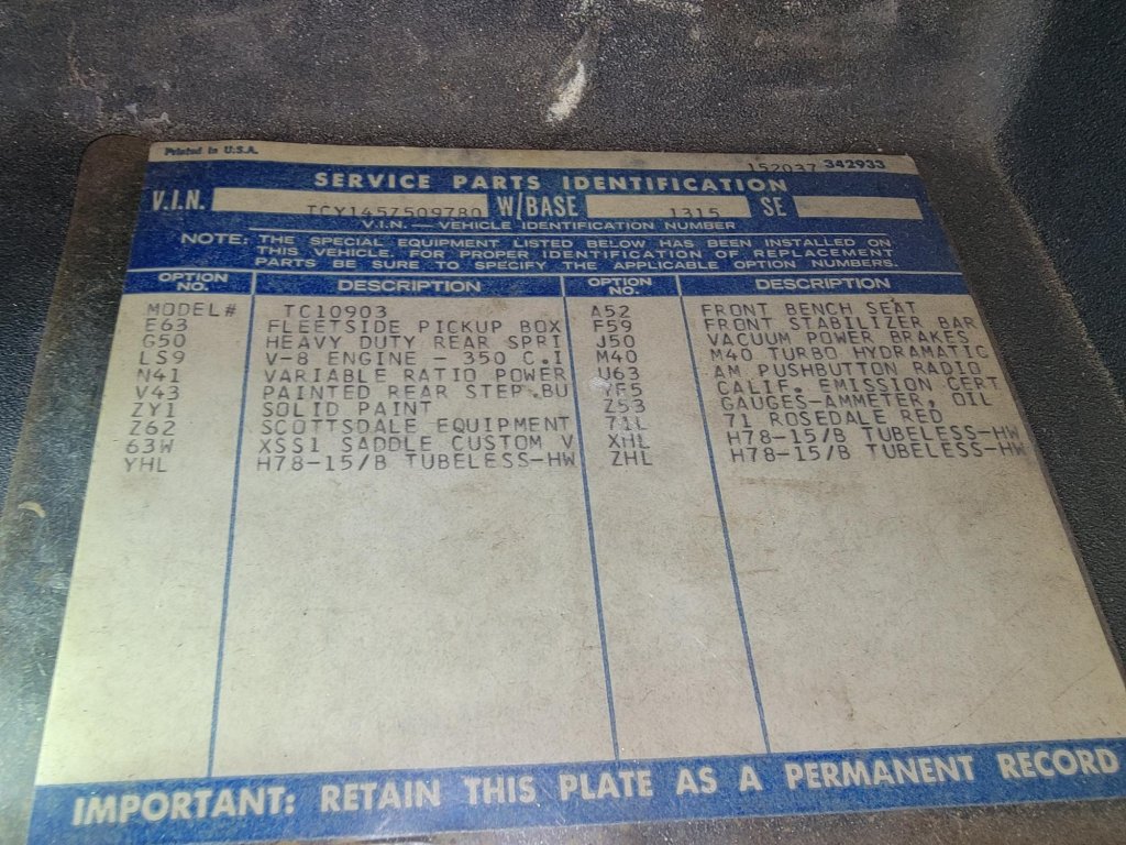

Looks like the color of my 75 GMC C150 Sierra. Rosedale red. Awesome job. Why not use a red tone paint. Sorry if i missed something. BTW, how do you get rid of little rust puckers, I have some industrial rust remover to apply, then what? I plan on painting same areas with a finish roller, as it has already been painted that way. It's just a work truck. thx
